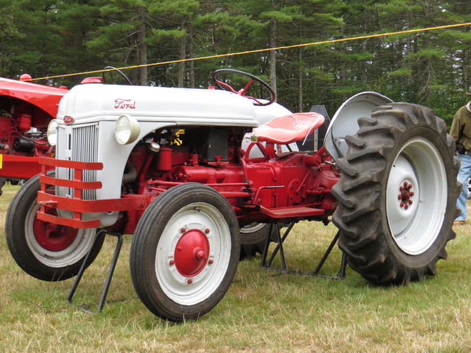

I'm helping a friend clean up his Dad's "estate". We found a device that you put under a 9-8-2N rear
axle that fastened to the 3-point, sat on the ground, and when you lifted the 3-point, it raised the rear end off the ground so you could remove the rear wheels for repair or painting. Did that have a name?

yup I have one. Ive used it on the NAA many times. They work pretty slick. We narrow up in the winter to move snow and widen it back out during the summer to rake hay with it.. I want to say dad has one to use on his 841 & 861 Too

I was wondering if it was heavy enough for the 600 series.

Lower the 3 point arms.

I understand how the tractor picks itself up but how do you lower it?

The opposite of raising it you just lower the 3 point lift. When you raise the lift arms it raises the tractor when you lower the lift arms it lowers the tractor.

 Re: Ford Self lift device in reply to Wheat47, 09-21-2019 19:58:38
Here is a good picture of the front bracket.
You can see the chain on the ground running back to the rear piece there is a small stud sticking up that the chain hooks on. Hope this helps BTW I paid $50.00 for mine complete. When I take it to tractor shows it usually gets a lot of attention most folks have never seen one.

Yep, the Dearborn K-P Self Levitating Device; I have two, and not just the rears either. The device includes a bracket so the front gets lifted as well. I use mine all the time -it's the best device for changing wheels around. I can do all four wheels in about a half an hour. Does yours have an ID TAG on it? What are you sking?
THE K-P/DEARBORN SELF LEVITATING JACK:

You need to find the piece that goes under the front end. It looks like a oblong loop with a chain attached to it. You hook the front to the back with the chain. When you pull the three point the two work together to lift the whole tractor. Good Luck.
