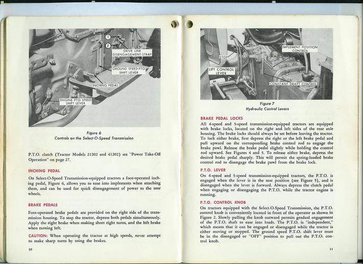

aydog1,
First I would check to make sure that the hydraulic selector lever is in implement position control mode.
The way it is reacting, I would guess it is either in constant draft control mode OR the system is badly out of adjustment which is usually caused by the cam follower pin being worn.
I have included pages from my operator's manual.
Keith
Search mower deck height stabilizer chains and brackets. There are some ready made kits that use the top link pin and the attachment lift arm pins to attach adjustable chains and brackets to for setting a fixed height for attachments like rotary mowers/cutters.
(quoted from post at 06:56:58 09/12/19) aydog1,
Keith
<img src="https://www.yesterdaystractors.com/cvphotos/cvphoto36270.jpg">
<img src="https://www.yesterdaystractors.com/cvphotos/cvphoto36271.jpg">
Keith thanks for all the great info. I don't have the draft in constant It's pointed to the front of the tractor. Where is the cam follower pin?
