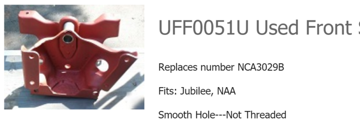

The axle pin and bushing are replaced. I'm not having a problem getting the yoke of the radius rod on the axle when the front axle is pivoted parallel to the rear axle. The bind occurs when the front axle is pivoted around the close fit of the new axle bushing and axle pin. While pivoting the front axle from the level position toward the position where the center axle contacts the engine support the radius rod yoke is enforcing a geometric change of relationship to the axle based on it's pivot location. When I pivot the axle on the axle pin I notice that the axle moves front to back on the new axle pin like one would expect but I wasn't prepared for the binding of the radius rod yoke pin against the axle. It is possible that there is no way to avoid the binding based on the clearances between these parts. Can anyone tell me if this is normal?
I went through the same issue with my 850, worn center pin, bent radius rods, straightened and wouldn't fit properly. I found that the axle bolster was bent throwing off the angle. I straightened it, which was easy to do and everything lined up. The tractor had a loader which I believe was used heavily and bent not only the radius rods, but the bolster too.
Thank you Glen.
I have read other posts with the term "bolster". If I am catching the context I believe what is referred to is shown below.
What process did you use to determine the engine support is bent?
What process did you use to straighten it?
How did you determine that you reformed the engine support to original condidtion?
Your help is greatly appreciated.
Another important piece of information is that the fit for the axle pin in the the engine support is such that when inserting the pin in either the front or rear hole individually, the pin only has a few tenths (.0001 inch) clearance. The fit through both holes is as good as it gets with only tenths of clearance. It's difficult for me to reconcile that the engine support is bent so perfectly that there is no residual stress in either wall to cause a slight misalignment thereby not allowing easy insertion of the close fitting axle pivot pin.
