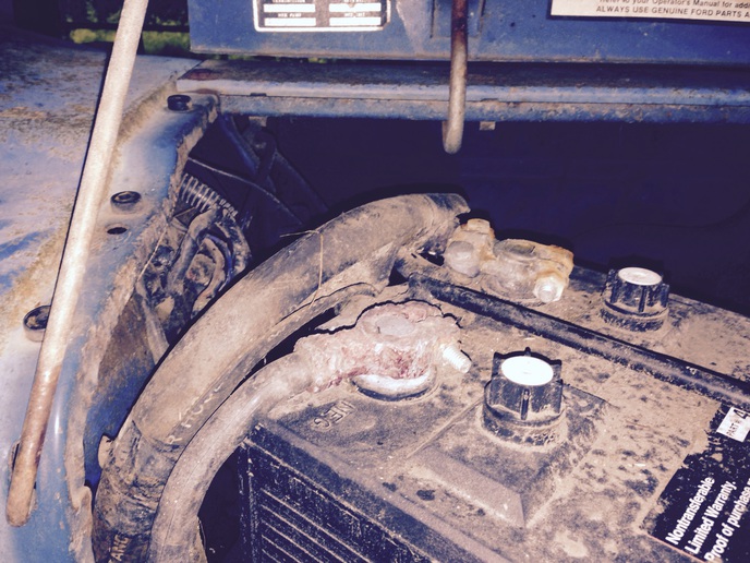

What year model is my ford tractor
Serial number-B996350
Model number- CA2136
I was told this was 3910 series 2?

Group 31 battery puts the studs or post up against the hood and sometimes doesn't allow the hood to close.
Group 49 battery is shorter and is a better fit, I have a group 49 in my 6610 and one of the 4000's, the rest will get changed over as the present 4DLT's go bad.

If I understand the question correctly, the problem is battery cables to the starter?
OTR truck dealers have everything you need to replace your two wires and if routed properly, no reason to chafe (opinion based on BTDT). Just take your old ones in and tell them to make you a pair of these.
While you're at it they sell Size 31, ⅜" stud post, 925 CCA batteries for like $75....just bought one first of the year.....stock them by the pallet load. Yes the terminals are on either end with the 31 but when you have your cables made if you want to use that battery, just have them make one of the cables the additional length to reach the terminal on the far end of the battery.

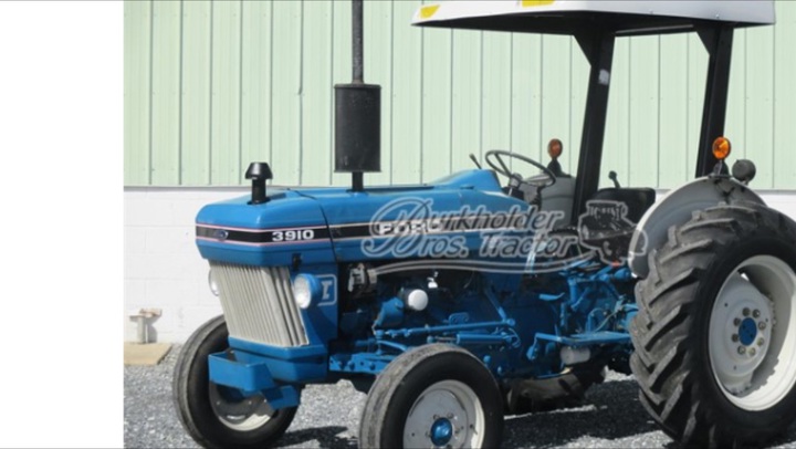

Don't know why posts from modern view don't show up in classic view, but Sean said he couldent find a good pic of the 3910 grill, as he said it is the same as a 4610, which is what I have, here's a pic of a 3910, there's no differences in them.

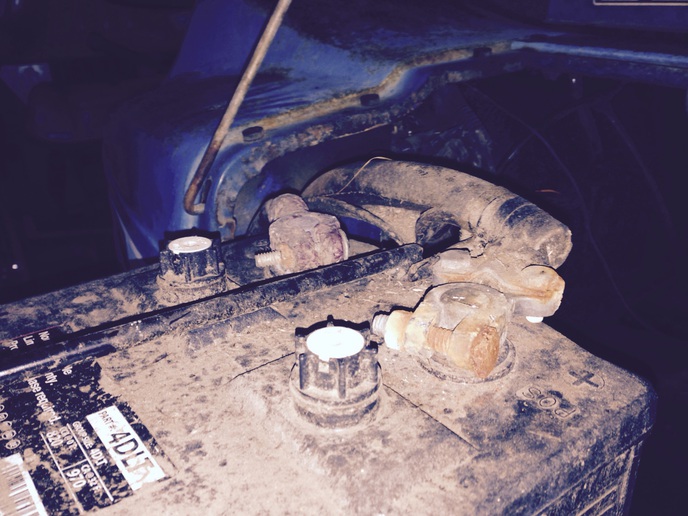

My guess is that the hood was replaced with one from a 3600. Look on the flat spot on the bell housing just above and toward the rear of the tractor from the starter. The flat spot is just above the two large bolt hole that I have circled in your picture. The serial number, model number, and Unit number should be stamped into that flat spot. They may be obscured by multiple layers of paint, so you may need to sand off the paint to see them, or you could try a pencil rubbing on a piece of paper.

Can't help you with your model, but that's a common problem with Fords, positive wire shorts out on the hood and they burn up, wrap a hose or something around the positive wire so that dosent happen again. Had that happen to a 4600 years ago.

Everything about it looks to be a 3910 Series II, grille, lift controls, planetary rear axle.
3910 unit number should start with CA4, not 2.
8F05B could be a build date of June 05, 1988 which is correct for Series II models.
NH is the only place to get a wiring harness for that model, if it burnt the wiring at the cluster you'll need a complete harness.
Cost around $275.
Ironically I'm fixing to bring a neighbors 3910 to my shop with a burnt harness, it didn't burn as bad as yours.

Well your pictures show a 3910 style grill.
Did you, in fact, get the model number, serial number and Unit number from the sticker under the hood? (I can't see a sticker in your picture that shows the hood up with the fire damage), or did you get the stamped numbers from the flat spot on the bell housing?

Unit Number 8F05B means it was assembled on June 5 1978 during the day shift. So the numbers are from the sticker under the hood? Then it's definitely a 3600 and not a 3910.

clean everything on the starter boss and look at the numbers again, the "CA2" is a 3600 from 1976-1981
