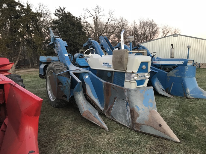

Ford9000puller, don't forget that the gray changed very significantly from XX0 to XX1. I would say that it has a little yellowish tannish tint to it depending on the lighting.

From what I have seen and studied I think the 62-64 tractors had a little different gray. Not as dark as the gray enamel on the 8n-x01 series and not as light on the 65 and up gray gloss. Anytime I paint a 62-64 2000 4000 or 6000 I mix the gray enamel and gray gloss paints from New Holland 50/50 and have been very pleased with the results. Here is our 63 6000 that was painted with the 50/50 mix.
