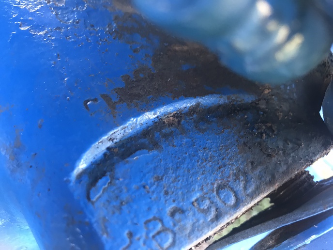

Destroked 450
03-14-2019 19:06:50
Report to Moderator
 Re: Steering column reverser on Ford 250c in reply to WorkingDad, 03-14-2019 06:37:32
BC90233 makes it a 91 model
The middle number look like 1F18?
Build date June 18 1991 ? shift.
Look at the front crank pulley
If it looks like this, it's a 192 engine and the tractor would be a 250C
If it has 4 holes like this it's a 201 engine making the tractor a 260C
[Log in to Reply]  [No Email]
WorkingDad
03-15-2019 09:47:08
Report to Moderator
 Re: Steering column reverser on Ford 250c in reply to Destroked 450, 03-14-2019 19:06:50
There we go - 250c
Thanks a ton man!

Destroked 450
03-14-2019 16:08:38
Report to Moderator
On older tractors like mine the C in the engine serial number represents a engine for a 3000 series tractor. Engines for a 4000 start with a D.
If Ford continued that numbering system for your model the C would be for a 3910 series engine which would have 192 ci.
250C is a utility model of the 3910 series.
The only difference between the 192 and 201 is the crankshaft, pistons and front crank pulley.
For normal maintenance and service all parts inner change.
The production date and serial numbers are located in the same area as the model number you posted.
Finding them will help narrow down when it was built and narrow down the models built during that time.
You may need to remove that small metal plate to get a good look at the numbers.
I've never seen that metal plate on a tractor before.

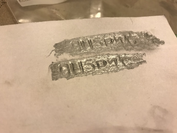

Wow, that alone is more info than Iíve been able to dig up in the last 6 months! So the 4600 manual Iíve been looking through is probably not totally relevant.
Thereís 3 lines with the serial number. The middle line is nearly impossible to make out, even with the pencil rubbing technique.
The best I can make out on the third line is: *BC90233*

Destroked 450
03-14-2019 15:26:18
Report to Moderator
Hadn't realized it has the wrong grill shell, the grill for a 250C looks the same as one for a 4610
They get beat up a lot on utility tractors and the aftermarket 4600 grill shell and grill are cheaper replacements.
The engines serial number is located on the blocks oil pan rail below the dip stick.
The engine production date is located on the side on the upper mounting tab.
In the photo you can see the two large bolts that fasten the engine to the front bolster, the numbers should be on the side of the tab for the upper bolt

WorkingDad
03-14-2019 15:37:33
Report to Moderator
 Re: Steering column reverser on Ford 250c in reply to Destroked 450, 03-14-2019 15:26:18
Ah, I think that is this one. Tried to get a photo of every min er I could find, itís sitting on some property right now about 30 minutes from home.
Best I can read is: C315902*

Destroked 450
03-14-2019 14:34:46
Report to Moderator
You pretty much answered your own question.
Your tractor has the standard 8x2 trans, not the power reversing trans.
Power reversing can not be added to the 8x2 trans.
Does your tractor still have the foil tag under the hood or has it been painted over.
I'm not familiar with that model but the only difference between the 250C and 260C I've found so far is the engine size
250C has a 192 ci engine
260C has a 201 ci engine
