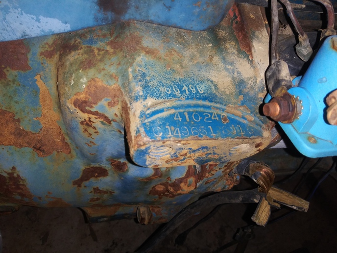

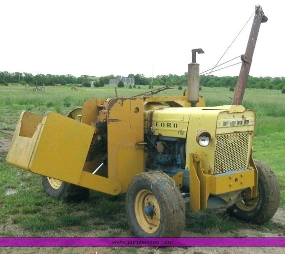

Report to Moderator
 Re: ford tractors in reply to rat0851, 03-04-2019 20:47:22
3550 production didn't begin until 72, your tractor is a 69.
Looking at your photo!
4500 has that oil tank made into the shell, parts look up shows a 3500 doesn't have the oil tank
4500 air cleaner access plate is on the left, 3500's is on the right.
I see power steering lines going down to the cylinder in the front bolster.
4500 uses this type of steering, 3500 does not.
There's another set of numbers in the same location as the ones you found, may be farther back in the unmachined area.
The model numbers for my 4500 are D5011K
D50 = 4500
1 = diesel engine
1= no pto
K = 6x4 manual reversing trans
Your's should have the same D50
Your looks to be diesel so should have the 1
Don't see a pto lever on the left side under the seat so another 1
D5011?
The last letter depends on the tractors trans option.

Are there any # locations that positively identify it as a 4500 ford or not. I noticed that the 3550 has the same heavy front end , flat plate at top in front of radiator ?
[Log in to Reply]  [No Email]
Ultradog MN
03-07-2019 12:11:57
Report to Moderator
 Re: ford tractors in reply to rat0851, 03-07-2019 11:31:05
Look on the bell housing - just above and behind the starter.
See photo.
There should be 3 lines of code hand stamped into the flat spot there.
You may have to clean/scrape/brush or chaulk to read them.
Post those and someone here can decipher them for you.
As for whether it's a 3550 or 4500;
Yes they used the same bolster but the power steering was different.
A 4500 and 4400 had the PS cylinder in the bolster under the radiator.
A 3500 and 3550 had external power assist.
Look at the heavy steering arm attached to the left side of the front axle on the yellow tractor.
And look at the side arm steering cylinder on the blue tractor.
Together that is the configuration a 3500 and 3550 had.

That would be an August 4, 1969 date code.

checked the # again and it is 9H04B

Sean in PA
03-05-2019 17:41:11
Report to Moderator
C245095 is a 1969 serial number.
9104B is not a valid date code. If it was a date code then the second character would be a letter, not a numeral. Also, since they did not use the letter I for the month, that 1 in the second position wouldn't be an I either, so if it is really a J, then it would be 9J04B, which would be September 4, 1969 during the day shift.
It may be an option code for the transmission. If it is then it will remain a mystery, as no one that I know of has ever explained what they mean.

rat0851
03-05-2019 17:16:59
Report to Moderator
I have the serial # from the right side next to starter, but do not know how to read it. here it is 9104B at top and under that C245095
Can you figure it out ? Thanks Randal

Ultradog MN
03-05-2019 02:24:46
Report to Moderator
A 4400 and 4500 are quite similar and use the same basic chassis.
The most obvious difference between them is the 4500 is an Industrial model and had a "hard nose" meaning it has a heavy guage, flat front radiator shroud. 4400 used the lighter sheet metal nose like the ag model Fords.
Also, the 4500 used a significantly heavier front axle than a 4400.
The engine, transmission and rear ends in both tractors are the same.
The first photo shows a 4500. Second one is a 4400.
