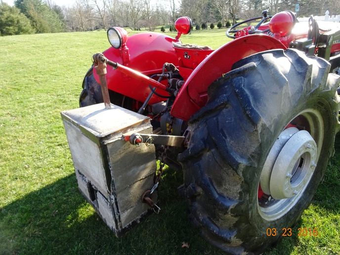

i like to ask some opinion on my 70 ford 4000su with front loader.
the tractor came with a large weight he would pick up with 3 point hitch. i believe this was home made. this weight is not going to get on the delivery truck.
what is the best alternitive for using the loader, not getting stuck etc. i have seen wheel weights, water in rear tires (cant be a good idea in the northeast). would like to know what you guys thinkis i. this forum has been suck a huge help, thankyou.

You can make a weight pretty easy with a 35 or 55 gallon barrel depending on tractor size.
Hanging any implement you have on the 3pt works but a bigger one can sure be in the way, awkward.
Fluid in the tires is great, calcium chloride or beet juice.
Lots of options.

what would be a good total weight to add to the 3-point hitch ? i was thinking of getting heavy bar bell weights and make a bar that could be mounted one of the 3 point Draw bar or something strong like that.

as the others said.. weight is king for a 2wd loader tractor. wheel weights are good, loaded tires are good ( load with antifreeze or ww fluid in cold areas ), and as said.. a 3pt weight is awesome and cheap and EZ to build.

Nothing compares to a three point mounted counterweight for FEL work.
Figure out a way to get it if you can.
Otherwise, you will soon be looking for another.

Hi, you will need lots of weight added to the back on any 2 wheel drive tractor with a loader. I added windshield wiper fluid (-20 deg. below type) to both tires, about 250 pounds of wheel weights to each side, and then made up a counterweight of about 700 lbs. of concrete with old iron dumped into it to hang off of the 3 pt. hitch and held up with a chain so that it does not ride off of the 3 pt. hitch hydraulics. The concrete weight can be taken off in one minute if it is not needed. Now it works great.

Swattley, you could easily build your own 3 pt counterweight like the one that is not getting on the truck. All you need is a barrel, a cross draw bar, piece of steel to extend out the top, and some mortar mix and a bunch of rocks. That counterweight could be attached before doing a loader "job." For everyday work you will still need either $500.00 worth of wheel weights or liquid tire weight. There are pros and cons to the various liquids, but calcium chloride is far and away the most popular. It is best used in tubeless tires but it was used in tube type tires for many years before tubeless tires took over.

I've often thought about this. What about welding up 3 point adapter pins to a 55 gallon drum then filling it with sand? You'd have over 700 lbs there.

I think that would be a problem, you need more structure than the wall thickness of the drum, sand won't provide that, but concrete steel, or cast iron will.
Many ways a weight box can be built too, fun little project. I lucked out with this treasured solid old cast iron weight with an 11 hole drawbar attached to it. I've heard the weight is from a Ford aircraft tug, drawbar is definitely Ford. One of the mechanics at our old dealership put it together for use in the yard. It remained and I ended up with it just when I needed it for a tractor.
