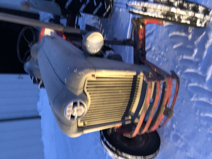

First time posting on this board. Have had a 600 on the farm for 40+ years. Tractor is used all the
time. When I was a kid I'd bet it was getting anywhere from 200-300 hrs a year. The other day it fired
up at say -5 to -10F. I had a 3 pt blade on the back and wanted to use it to pull some snow away from
some buildings. The 3 pt is one thing rarely used in the winter so maybe just never noticed this before.

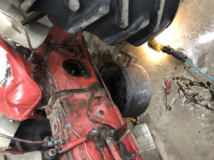

After reading stuff online some talked about sludge in the bottom of the hyd reservoir. Never having been
in there for a really long time I removed the PTO lever/cover and found things to be very clean inside.
There was a also a plate on the bottom of this reservoir so I took that off pretty much finding nothing.
We simply run in the hyd portion was we call UTF, or equivalent of Deere Hygard which I run in all of my
farming tractors.
Is my pump worn, oil too heavy for these temps, something in rockshaft cover causing this, looking for
tips and ideas. Sorry for the tipped photos. Unsure in this forum how to rotate them. TIA
The "plate on the bottom" provides access to the relief valve. DO NOT use goop on this plate upon reassembly.

To answer some questions. I would say there was no water contamination and zero ice. I'd say hard to believe any gear lube migrated in there as the level was good. 25-30 years ago we were changing oils and the operators manual listed an oil for the hyd section but when we took that book to the Ford dealership it was all deer in the headlights trying to figure out what oil that has now become. They were basically it is too old for us to know, which I kinda understand. We are all green except this one tractor. In the Deere world they use Hygard in everything modern but stuff like combines for a long time used "low viscosity" Hygard in their hydraulics. Low vis is basically 10W and maybe a lighter oil would help in this situation. When I started it that day it took 25 minutes before it basically raised. After I used it for another 25 minutes it wasn't so bad.
The Low Viscosity Hygard is what is spec'd for the hydrostatic transaxles in JD lawn & garden tractors. I use it in both of mine. It is a little thinner than the Traveller's Premium UTF that I use in my Ford 4000, but not by much. If the regular Hygard is much thicker than that then I could see why a Ford 600's hydraulics would be slow in the cold weather, but if you're saying that's what you've been using for 25-30 years and this winter is the first time it's been slow then it must be something else.
I've had better results with synthetic oil that is less effected by temperature (high or low ). The system is very early technogly so not so good by modern standards. We seldom see less than 20F around here and Ns/hundered Fords were slow for first hour when tractors were new. Even with a new pump,there's a huge difference in how a loader works compared to 10 year later tractors. That's why most people add a pump to pto or front crank when a loader is installed.

So. back to your question. IF your running a gear lube in your hydraulics, its too thick for cold winter use (below 10f) unless you dilute it. If your running a type A hydraulic fluid or better, its ok for round the year use. You tractor did NOT have wet brakes, or wet clutches, or extreme high pressures... that required a synthetic blend, nor was it made after 1975 with the higher pressures. So about any UTF (Universal Tractor Hydraulic fluid) will meet or exceed your tractors specification for Type A hydraulic fluid for use in all temps. If your operating continuously in sub zero temps, you might want to bump the hydraulic fluid to a synthetic blend to give you even better service. But then you would need to change all the other fluids for extreme cold weather work. Also you would have to watch for water vapor in the gas tank and lines freezing as well. The ford 641 is not the best tractor to use at -40 degrees anyway.
