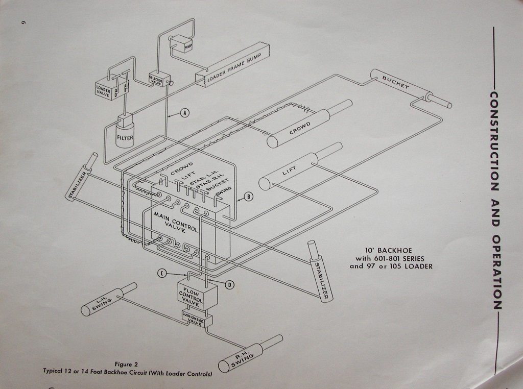

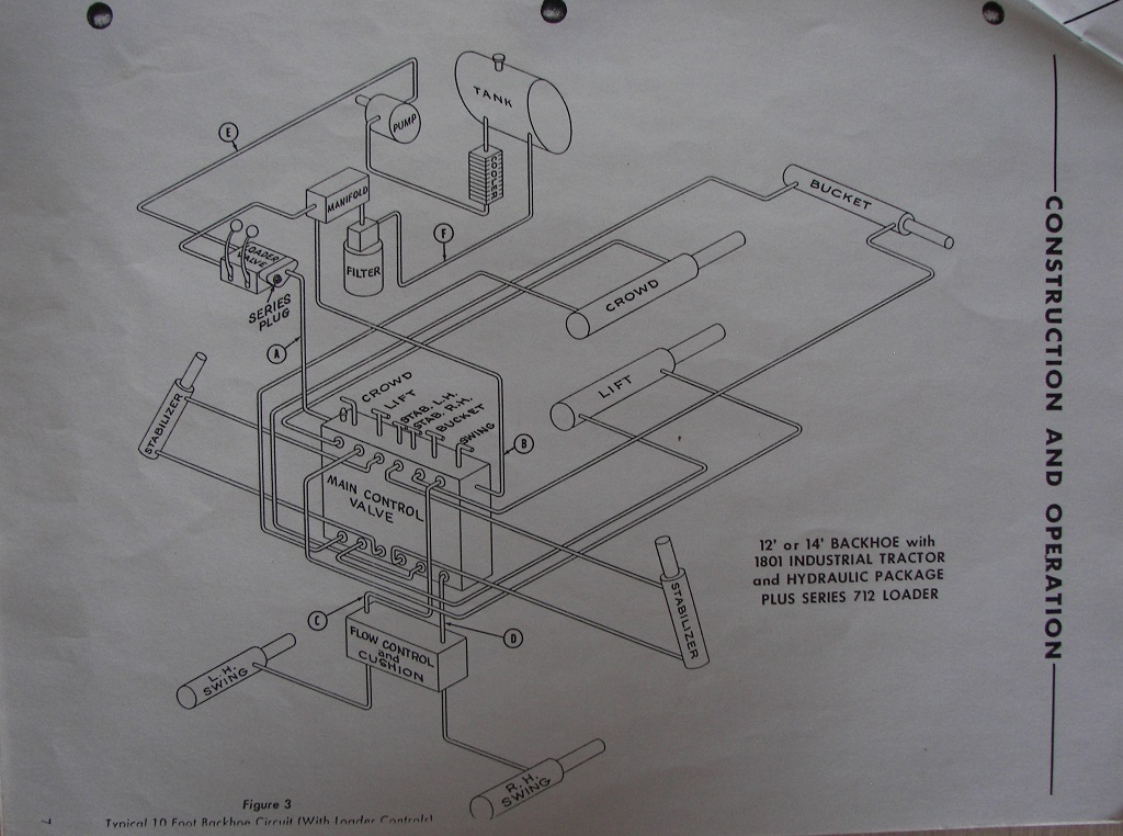

First, the 713 is a prior generation backhoe to a 3400, the "native"
backhoe for a 3400 would be a 750 or 753.
Anyway the hydraulic plumbing kind of depends on what loader/backhoe
combination you have. Below are two circuit diagrams for the 713,
one for a 19-97 or 19-105 loader with selector valve (no power
beyond), and one for the industrial setup, 712 loader with power
beyond on the loader valve.
I'm not sure what loader you have, but if it has power beyond you
would send the pump output to the loader valve and the on to the
backhoe similar to the second diagram. If it has a selector valve,
the setup would be similar to the first diagram. The third picture
is the selector valve on my tractor (19-97 loader and 713 backhoe).
Since you are "mixing and matching" you'll have to figure out what's
best for your situation.
Another thing, if you blew the lines off under a no-load situation
you may have deadheaded the pump somehow. Be careful, such a
situation can blow up the pump.
