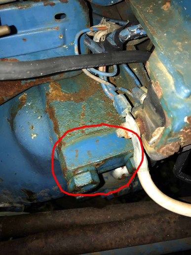

geldred
10-02-2018 06:22:02
Report to Moderator
 Re: 3600 3 point won't raise in reply to geldred, 10-01-2018 06:40:52
third party image
third party image
I tried finding the serial number again last night. Here's a picture of where I think it should be. Am I looking in the right place?
[Log in to Reply]  [No Email]
fordfarmer
10-02-2018 07:26:11
Report to Moderator
 Re: 3600 3 point won't raise in reply to geldred, 10-02-2018 06:22:02
Yes, that's the right spot, though sometimes you have to look farther inboard to find all the numbers. Also, if it has an A or B prefix serial number, some of the numbers may be stamped on the opposite side.

geldred
10-02-2018 06:23:27
Report to Moderator
 Re: 3600 3 point won't raise in reply to geldred, 10-01-2018 10:40:50
Here's a wider shot of where I think the serial number should be. Is this the right location?
third party image
