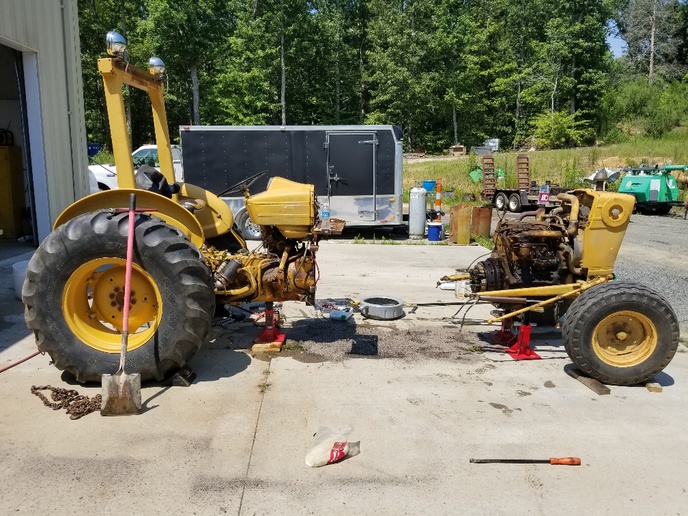

Hello. I believe I have a ford industrial tractor. I need to know the year andmodel number so that I can order parts and a manual. The serial # on the engine (C248198) I believe suggests that it is 1969 but I am not sure. I don't have the model # on the plate next to the starter but on the opposite side of the tractor I ran across these numbers stamped on bell housing (4C06B, K7008). The starter side of the bell housing looks like it broke off and someone tried to repair it. I have a couple of other numbers that may help to identify the tractor.
Engine - D5NN6015F, C248198
Injection pump - 3233F631, R19376 HA
Transmission right- D2NN7006A
Transmission left - D3NN4024AD
Any help would be great. I'm trying to fix several things on the tractor for my dad. Thanks!

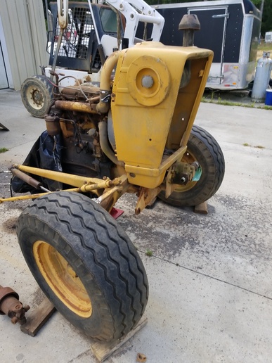

The extra pics helped.
Wrong axle for a 340
Axle, sheet metal and such indicate it's probably a 335, the March 74 transmission production date is a little early for a 75 model but not impossible.
Production dates from the engine and axle would help.
Engine production date is located on a small flat pad under the injection pump.
Axle date is on or just behind the axle to trans mounting flange behind the shift top.
These numbers will be hand stamped, not raised casting numbers.
A 335 is a 3600 series tractor with a utility front axle so other than the front axle components parts for a 3600 ag tractor should work.

OK, I just read your first post again. The fact that it has no numbers stamped on the flat spot on the right side and has those two numbers on the left side probably means that the transmission is not original to the tractor, so we can ignore the date code there.
The other casting code numbers indicate the castings were designed in '72, '73 & '75, so with that nosecone and the dry paper filter on the right side of the for a diesel engine I would assume that it is a 335, which was made from 1975-1978. I would think that a 340, which was made from 79-81, would have at least one major casting code from after 1975.

Not a lot to go on but it's defiantly not a 69 model
D5NN casting code on the block says the block casting was designed in 1975, D2 and D3 trans code makes it newer than 69 as well.
4C06B on the trans is a production date of March 06 1974 or 1984
If it's a 74 model the engines been changed so most likely a 84 model.
The rear axle is of the lighter 2-3000 ag style so most likely a under 50 hp utility.
Best guess without more info and photos is possibly a 340 model.
If the engines been changed it could be one of a few other models
Post pics of the front and sides along with one of the damaged area.
Note: Not sure what the reason is for the short section of pto shaft tied up with the top link, but that's a good way to get the pto shaft broke out of the tractor plus possibly getting someone hurt.
Get that off the tractor right away, if someone were to accidentally engage the pto things would go south in a hurry.

I will definitely remove it from the PTO. My dad tied it up for some reason. I will attach some additional photos. Hopefully this will help. Let me know if you need any additional numbers off the tractor.
