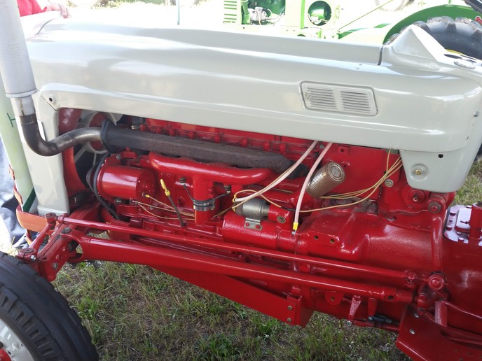

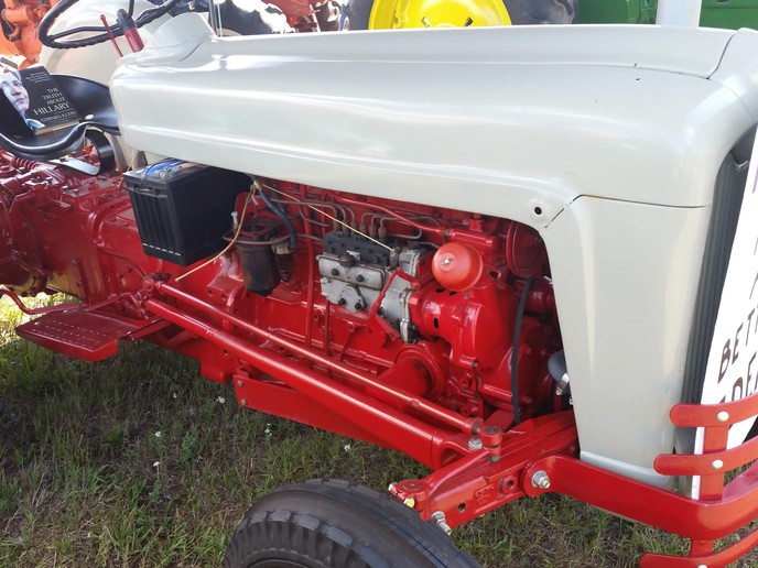

Saw this 820 with a 6 cyl diesel engine from a 6000 commander transplanted into it at the Walloon Lake Flywheeler show. Talked with the builder, the trans and starter bolted right up. He did stretch the hood sheetmetal and the radius rods. Note the belt was off to drive the injector pump so tractor was not in running condition.

Interesting, looks like a 7 or 8 blade plastic fan.
I like the rusty soup can covering the intake pipe too.

 Re: 6 cyl diesel in a hundred series in reply to michford, 07-28-2018 20:06:05
Flow the lines. Looks to run hyd pump for3 point.

 Re: 6 cyl diesel in a hundred series in reply to Shaun Wallace, 07-29-2018 05:14:06
Good catch! I didn't notice that the hydraulic pump was missing. I doubt that 3-point will lift many heavy loads with a belt driven pump.
Very nice looking job - thanks for sharing.
That said, the belt does not drive the injection pump.

 Re: 6 cyl diesel in a hundred series in reply to Bern, 07-28-2018 21:00:21
Now that you say that about the belt, I wasn t thinking right. The injector pump has to be mechanically driven so it stays timed correctly. What should the belt be driving on the engine?

 Re: 6 cyl diesel in a hundred series in reply to michford, 07-28-2018 21:15:14
PS pump.

 Re: 6 cyl diesel in a hundred series in reply to Dean, 07-29-2018 05:47:11
That was my first thought too... but there aren't any p/s cylinders.

 Re: 6 cyl diesel in a hundred series in reply to fordfarmer, 07-29-2018 07:27:49
There would have been on the 6000.

 Re: 6 cyl diesel in a hundred series in reply to Dean, 07-29-2018 10:12:12
PS pump on a 6000 was mounted on the front cover and driven directly by the timing gear train.
Fan, water pump, generator...
