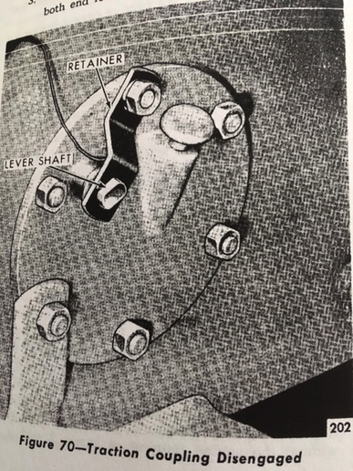

I have a 881 sos that im going to part out. Is there any value in the trans and rear. I know nothing about the tractor. Thanks for any help. Ed
Destroked 450
06-24-2018 14:49:49
Report to Moderator
 Re: 881 selectospeed in reply to 400dtractorman, 06-22-2018 18:33:43
Found it! Rotate the shaft clockwise to to disengage the coupling, counterclockwise to engage.

Destroked 450
06-24-2018 14:44:59
Report to Moderator
The transmission won't come out of park without the engine running.
To move the tractor without the engine running there's a traction disconnect on the left side near the rear of the foot board.
third party image
Remove the bolt, take the retainer off and turn it around so it's sticking out, while rocking the wheels move the lever/retainer backward or forward (don't remember which way), it should move around a quarter turn, this will move the slide coupler in the rear axle disconnecting the trans from the diff.
Afterward you'll have to reengage the disconnect to keep the tractor from rolling off, or you could chock it but don't lose the retainer.

400dtractorman
06-24-2018 13:01:26
Report to Moderator
 Re: 881 selectospeed in reply to Larry NCKS, 06-22-2018 19:08:34
Do you know how to get it out of park? The lever is moving but its stuck. Wheels just slide. Thanks Ed
