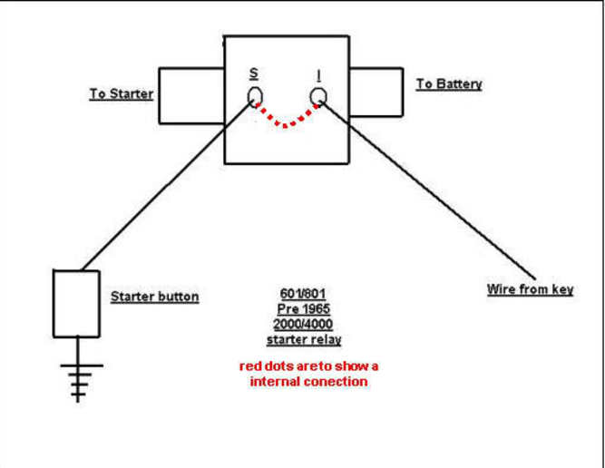

Johnnykick
05-28-2018 11:13:02
Report to Moderator
 Re: 4000 Won't crank in reply to johnnykick, 05-27-2018 08:54:36
Thanks for the drawings...we have it wired that way except have bypassed the ignition switch.
I performed a search for the Tisco, Part number D2AF11450AA solenoid that my son purchased...came across this YT thread from long ago:
https://www.yesterdaystractors.com/cgi-bin/viewit.cgi?bd=ford&th=355914
So I run a test putting the hot on terminal S and bingo, it worked. I'm ordering the recommend solenoid:
http://www.link_disallowed/cgi-bin/sh000002.pl?WD=uf40680&PN=UF40680--Starter-Solenoid--relay-type---Replaces-311006-71687%2ehtml#SID=9847
As they said, not all 1964's are created equal.

Dollar Bill
05-28-2018 03:23:33
Report to Moderator
Quoting Removed, click Modern View to see
12 volt conversions can be troublesome to isolate a problem due to the myriad ways of making the conversion.
Attached are diagrams that may prove helpful in your fault isolation - Good luck!
third party image
third party image
[Log in to Reply]  [No Email]

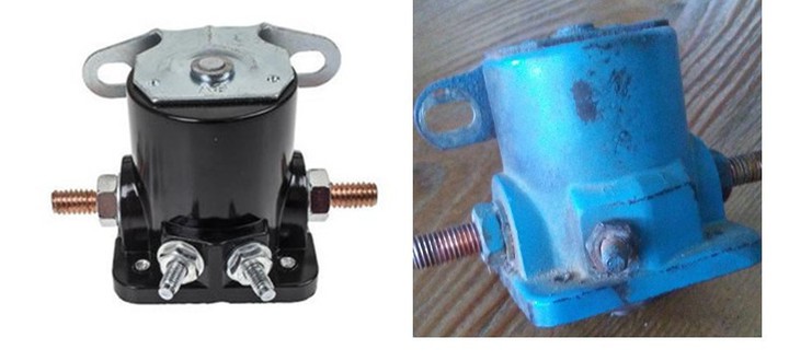

Larry NCKS
05-27-2018 15:38:09
Report to Moderator
A tractor that age has been around a good while. If it's been owned by anyone else it's hard to tell what mods they did to it. I believe Ford stopped using the 3 post somewhere in 00 series tractors, but am not absolutely certain of that.
My guess, from afar, is that you have the automotive 4 post solenoid and need to find one that grounds at one of the small posts. If they're marked that should be the S terminal. I know NAPA has the correct one as I've seen others post NAPA parts numbers here.
The difference between the 3 post and the 4 post is that the engine should crank whenever the starter switch is activated whether or not the ignition switch is on with a 3 post. The 4 post requires the ignition switch to be turned on to provide a source of power for activation.
Johnnykick
05-27-2018 15:06:53
Report to Moderator
third party imageI tried your instructions and no change. I've uploaded a photo of the old relay and the new one. Neither relay has lettering identifying the terminals. I'm puzzled as to why this tractor had a 3 terminal...I did some additional reading and the 4 terminal should work for this model.
Larry NCKS
05-27-2018 14:17:45
Report to Moderator
Nope! The safety on this system is that one cannot depress that button if the transmission is not in neutral. It only serves as a grounding point for the starter solenoid.
Larry NCKS
05-27-2018 14:15:24
Report to Moderator
'64 should have a four post. With the I terminal verified hot, try grounding the S terminal direct to chassis with a new wire that is verified good with an ohmmeter. If that doesn't work, you have the wrong configuration in your 4 post solenoid as others have said. The more common 4 post automotive solenoid provides unresisted power to the ignition circuit from the I terminal rather than a grounding source for the starter.
