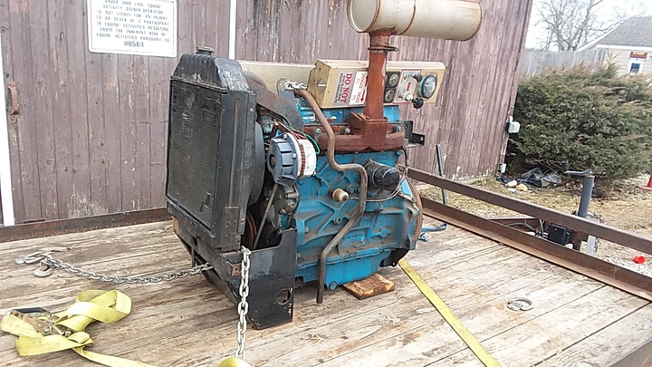

Over the last few months Ive been reading posts on this particular forum to educate myself as much as possible in regards to engine swaps and what will work in/with what. I decided to join the forum today as I am going to begin my project this morning of swapping out a ford 201cid engine with a bsd 268cid in a 455c. I've seen mixed opinions on this subject between this and other forums that are online. I'll be incresing the power by about 25hp but dont plan on running this thing with the throttle pegged. I'll be pulling the 201 today, blasting/painting this week and dropping the 268 next weekend along with some minor adjustments that will be made for proper fitment. I do have a complete replacement with radiator/fan, flywheel,wiring harness ,ignition Acc, etc. on the 268 which has 459 hrs. on it.

04-29-2018 09:37:39

ppabs1
04-29-2018 09:35:18
Report to Moderator
 Re: 201/268 swap in reply to ppabs1, 04-29-2018 06:10:22
[img]
third party image
[/img]
[Log in to Reply]  [No Email]

Quoting Removed, click Modern View to see
Like I said the 268 is complete. In fact I took a 4dlt battery with me and I started it before I bought it in New Castle Pennsylvania on the spot without it being in a machine. It has the wiring harness the ignition to starter injection pump the radiator fans everything is there and complete

You also need to remember that if you reduce the RPM of the engine you will also be reducing the flow rate (GPM)of the open center main hydraulic pump which will effect your cycle times.

That's a 30% increase in h.p. and torque... and peak torque for a 268 is at 1600 rpm. I think I'd do like Destroked said - fix the 201 and sell the 268 or use it in another project.
That said, if you do put the 268 in, what are your plans for the 201? I know a couple people who'd be interested in it, if it's close enough.

I've alway liked the 4 cylinder 5030 but your working on a Industrial model with industrial sheet metal, will the hood for a larger 4 cylinder model fit yours, if it has a loader have you checked to make sure the loader will clear the front grill shell once it's moved forward nearly 5".
Besides engine controls you'll need to lengthen lines for the steering as will as oil cooler lines.
If it has MFWD the drive shaft will need to be lengthened also.
Personally I'd fix the 201 and save the 268 or sell it for nearly enough to pay for rebuilding the 201.

As the others have said, going form a 3 cylinder to a 4 cylinder engine will require more3 than the parts that you listed. You will need longer 4 cylinder style hood panels at least.

Please take lots of pictures. As the 201 is a 3 cylinder and the 268 is a 4 cylinder the engine is at minimum 4.4" longer. It is going to be interesting how you adjust all the other components.

3 cylinder to 4?
