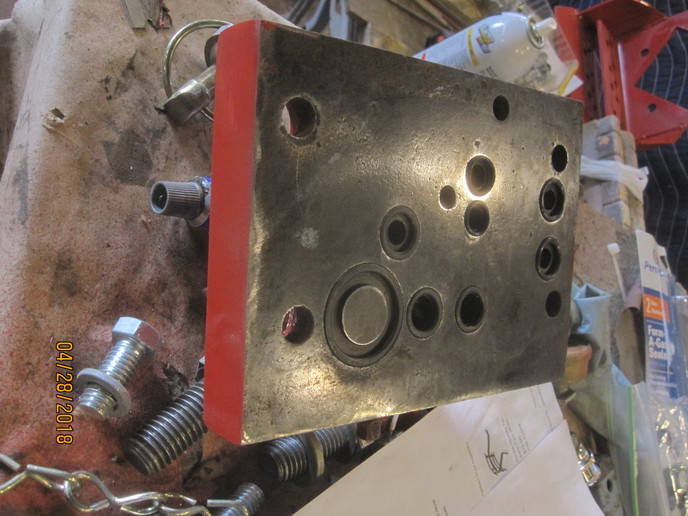

What do you use to secure O rings before installing
In many instances I have to install
small O rings underneath a part before installing
it down. (pump manifold, remote hydraulics, ect)
What do you use to keep them in place.
(super glue, non hardening permatex,???)
The pump manifold and remote hydraulic oring applications are all a face seal type application. Being a face seal, the orings fit into a counterbore that keeps the oring in place if the correct diameter oring is used. The correct oring will not just loosely fit into the counterbore, you will have to push the oring into the counterbore where will stay put.
I'm with the Vaseline crowd! Heat will dissipate Vaseline whereas some of the greases can stay intact and cause problems if they get in the wrong place.
Vaseline, use it inside auto transmissions to lube o-rings on rebuild. It's petroleum and melts at a low temp.

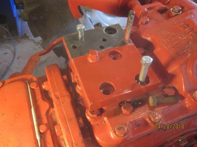

I took your advise
First I installed the 8 O rings on the bottom of the plate.
I installed dry. Then turned it over and tapped on the
plat to insure no O ring would fall off.
Then I used the vasalene to coat around the bottom
plate holes. To insure that if the plates miss-register on
bringing them together The O rings would slip on the
bottom and not tear out the O ring from the socket.

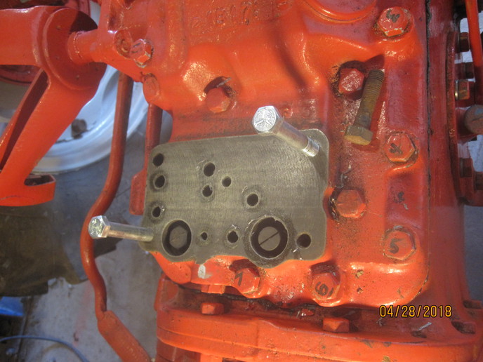

I also set up two long bolts to use as guides to hopefully
make good registration.
Then I put the bolts through the top plate and
turned a few threads. Then lowered the top plate
till it was flat on the bottom.
I hope all went well.
Somehow you missed something in the translation. You smear vaseline around the recess and use it like glue to hold the o-rings in place. Then you can also lube the o-rings themselves so they slide and not grab the mating surface,
Yes,
I thought that if the O rings were holding
in the recess I would be OK. I took it
apart and re-did the rings with Vasalene
and then reinstalled the plates. With a
total of 8 O rings both large and small
it is good to use any trick that will
forestall an error.
