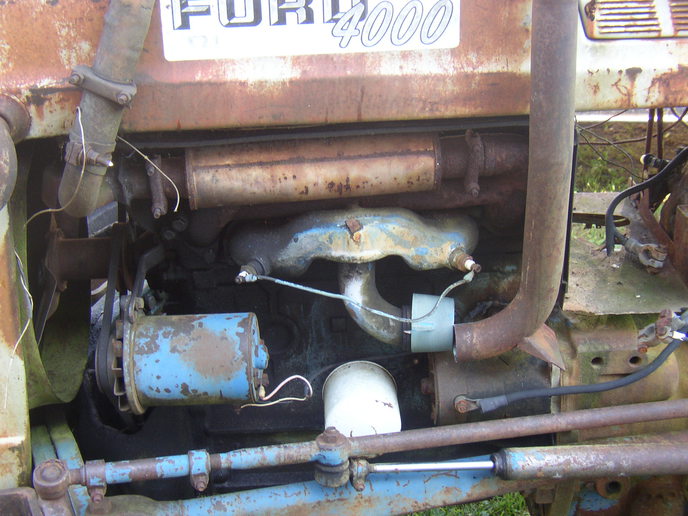

I have a '63 4000 with a 172 diesel.
I would like to know if someone could tell me what, the thickness is suppose to be of the shim, that's under the injector pump drive gear.
I have searched, and can't find out anything about it. It does not show it, or talk about it, in the parts book, or the service manual.
Thanks, Pat

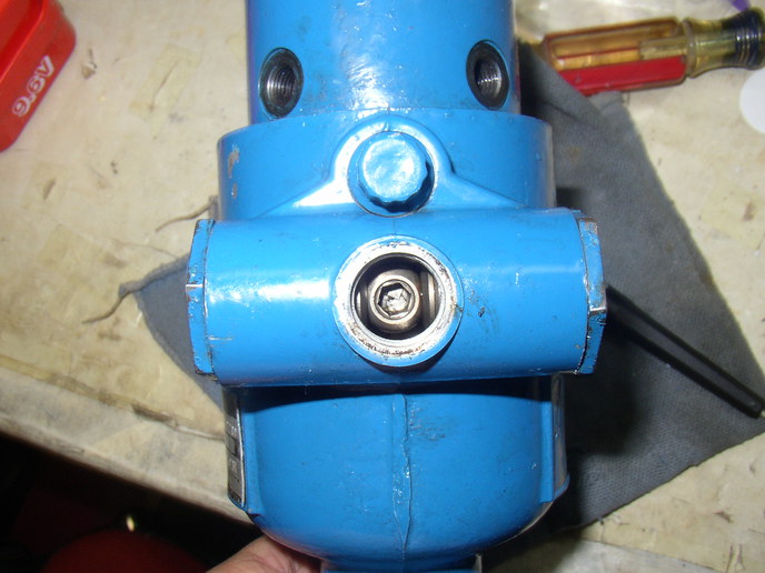

The two holes in the first picture, the top hole is the "governor advance bolt" hole, and the bottom hole is the "bolt" hole. Not the way I said it in the first post.
Pat

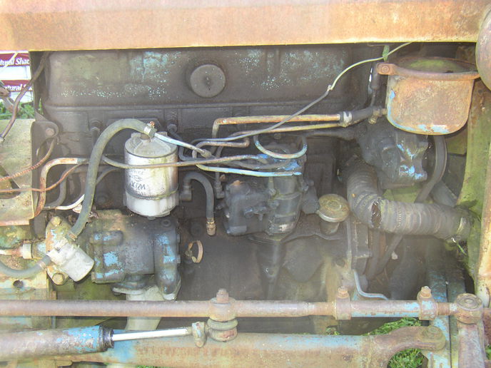

TinCan
05-05-2018 17:05:46
Report to Moderator
 Re: Injector pump drive gear in reply to TinCan, 04-15-2018 17:11:05

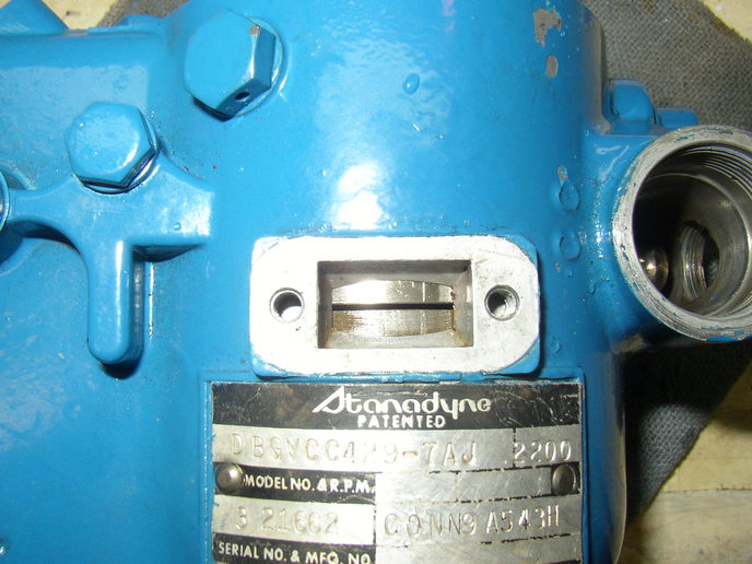

In picture # 5, you can see the fuel inlet at the bottom, which is inline with the casing to show the offset of the shaft.
Pat
[Log in to Reply]  [No Email]

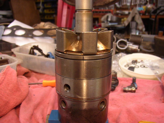

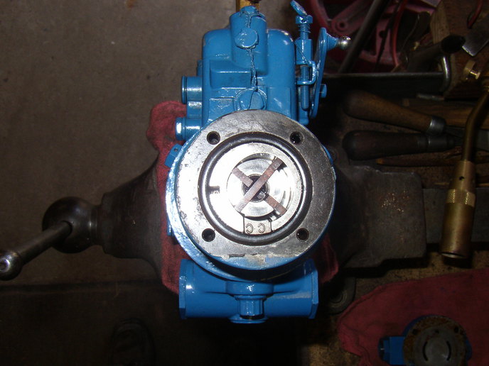

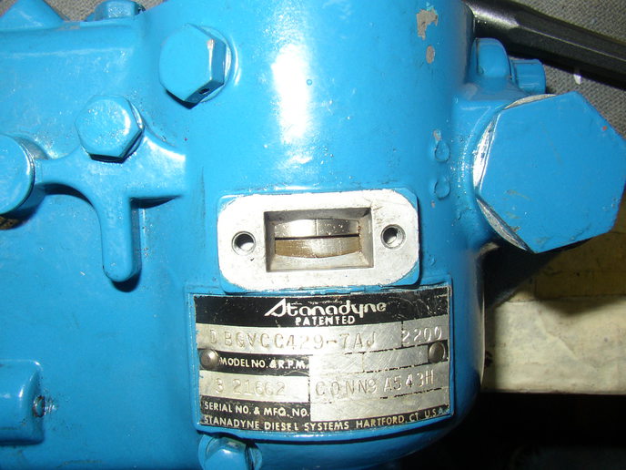

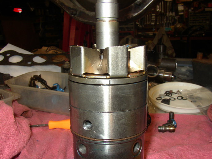

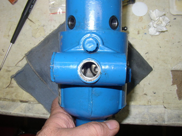

05-05-2018 17:01:42
Report to Moderator

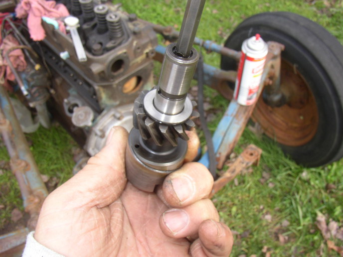

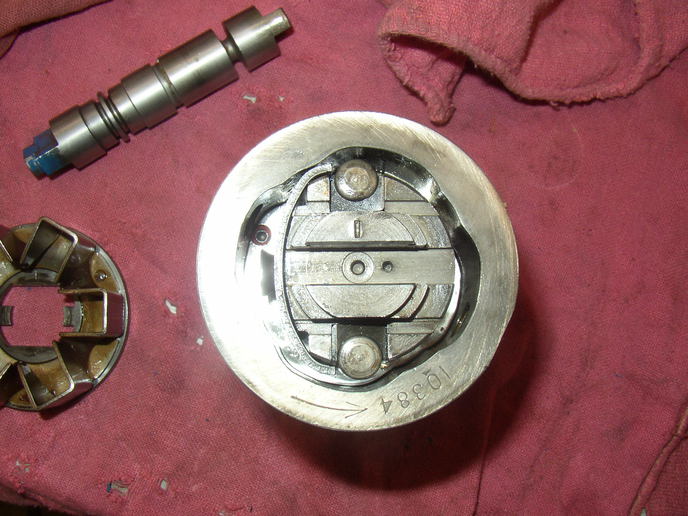

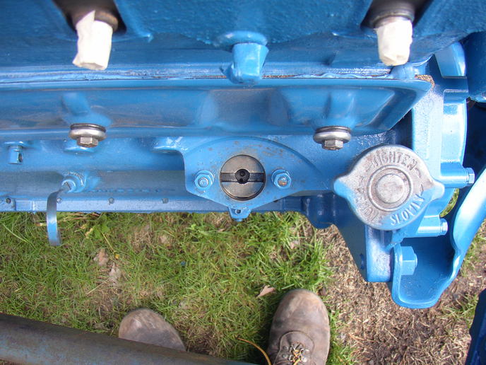

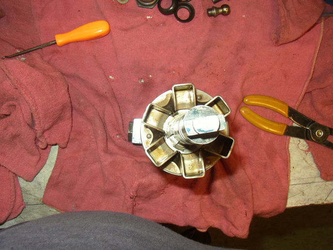

Ok, I got my seal kit, and went to town putting it back together. It is still the same. My question is, is there more then one driveshaft for these? If so, are the ends clocked the same?
In my pictures I have put everything together without the casing. The two holes in the first picture, the top hole is the bolt hole, and the bottom hole is the governor advance bolt hole. Both are inline with each other as they are suppose to be.
Picture two shows them with the casing on.
Picture three shows the timing marks lined up, as they would be in the casing, and on center of the window.
Picture four is after I picked up the cage and flipped the governor timing ring over. It makes no difference, the timing makes line up the same!
Picture five shows how the driveshaft is turned, to the same place it was before I started this. (See picture with casing on, in earlier posting)

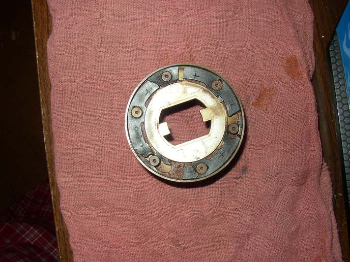

Picture six show the different offset in the tow drive ends, which is what I can only think is not right.
What do you think? There is nothing I can change inside to make it right. Flipping the advance ring does nothing, it sits the same both ways.
I have first done all this with the casing on. It came up the same.
What are your thoughts on this. I need help to get this fixed right.
Thanks, Pat

TinCan
04-24-2018 12:25:47
Report to Moderator
Ok, after I switched them, it changed nothing. So I was looking it over, and I have 2 question.
First, when the timing marks are inline, where do they usually end up in the window? towards the left side, center, or towards the right side of the window?
What would make the governor mark be towards the right side of the window? Assuming it should be near center.
when I put the drive straight inline with the mounting bolt holes, the mark is way to the right side of the window. Then when I match the timing mark to it, the bristle is way to far to the right for any kind of shimming. The first picture is when I turn the drive shaft to match the timing marks
The second picture shows where the bristle ends up. Way to the right.
The third picture I centered the bristle, using both timing plugs in.
The forth picture is where the timing is then.
The fifth picture is where the drive shaft is, and it must turn farther CC to bring the timing mark to the center.
I believe I have to pull the pump apart to see why the governor plate mark is off to the side.
Do you have any idea's as to why it is, or am I wrong on my thinking?
Thanks, Pat

Thanks again, Pat
third party image

Destroked 450
04-23-2018 21:31:21
Report to Moderator
This is the timing advance
third party image
Larry NCKS
04-23-2018 18:35:35
Report to Moderator
I should also add I don't think you have room to remove the inner one with the pump on the engine. Furthermore, swap the whole assembly, button and all.
Larry NCKS
04-23-2018 18:32:37
Report to Moderator
Quoting Removed, click Modern View to see
Nope! he's talking about the advance piston assemblies. These are on the back side of your pump. IIEC they require a 1- 1/8 or 1¼ wrench or socket.

Destroked 450
04-22-2018 18:21:51
Report to Moderator
What your describing is a classic example of the timing advance being put together backwards, no mater how you move the gear or twist the pump it won't time up.
As for the 144 pump they have different fuel rates but mount and time the same.
When I bought my 881 the pump was leaking around the throttle shaft, we installed my brothers 144 pump on my 172 engine in order to take the tractor on a club drive and left it on there until my pump was resealed.
Many years ago I bought a basket case 871 diesel, I rebuilt the engine and had the inj pump rebuilt, we couldn't get the pump timed right and the tractor ran like poo, after fooling with it for nearly a month a old mechanic mentioned the advance could be put together ether away but would only work properly one way.
We took the advance apart and swapped the parts around in the other direction, when we reinstalled the pump it timed up perfectly and the tractor ran great.
Some years later my brother was having problems with one of his 671 pumps he'd had rebuilt, I reminded him of the problems we'd had before with the advance, he checked and found the rebuilder have put the advance together backwards.
The only other issue I have heard of is if the wrong cam gear has been installed but I'd swap the parts in the advance first.
TinCan
04-22-2018 17:00:50
Report to Moderator
I have contacted Dieseltech, I am waiting for him to check something.
Mean while I took the pump covers off, It has been partly a part before. The lock wires were off the top cover, but on the linkage cover. I watch some videos on rebuilding it. The pump insides would have to be really messed up for the lines not to match up, from what I have seen. All the videos I watched showed the liner with the "C" up, mine has the "CC" up, but I do not know which way is right for mine.
I put every thing back together again, and tried to put the cam gear in on different teeth, but none would line the marks up. I had the engine sitting on 23 degrees before. I pulled the front engine cover off again (there goes my new gasket. lol), checked to make sure the timing marks were right, the dots match up. It has had the cover off before. The cam retainer has a new bolt in it. Why, I don't know.
It started to drizzle out, so I had to put the cover back on for now, and stop.
Can someone tell me the difference between a 9A543-H, and a 9A543-J . I have a 9A543-H on my "172". Which is listed as for a "144" engine. 9A543-J is listed for a "172" in my parts catalog. I was told at one time, it does not mater.
So what's the difference, the fuel setting?
If anyone can help out, I could definitely use the help!
Thanks, Pat
third party image
third party image
Destroked 450
04-19-2018 14:30:28
Report to Moderator
You need to contact Dieseltech on this site, he can walk you thru what needs to be done.

TinCan
04-18-2018 09:48:26
Report to Moderator
Destroked, I could not tell if the pump had ever been apart, but I do know it was off, because of the shims under it.
No it was not running when I bought it. I was told that he used it all the time, and parked it in a open front & back shed on the side of the barn. Then he died, 15 years ago. It's been sitting right where he parked it. Except a tree fell on the shed, and the son in-law removed the shed, and never moved it. He did not know how to start it (it didn't use a key), and being a SOS, he couldn't move it. But as dirty that it was from old diesel fuel on it, it had been running, long after it was worked on.
I'm going to look up that thread, and read it.
Pic's are where it sat for 15 years or so, engine pic's are after I got it home.
Thanks, Pat
third party image
third party image
third party image
third party image

TinCan
04-17-2018 16:39:38
Report to Moderator
I have installed the drive gear back in, and with the timing mark at 23 deg's the drive sit's straight like it should. But when I installed the injector pump, I could not get the pump marks to line up. with the pump off, and I line the marks up, the dog is no straight inline. In the picture of the bottom of the pump, the lines are inline with each other.
So how do I fix that?
Thanks, Pat
third party image
third party image
third party image
