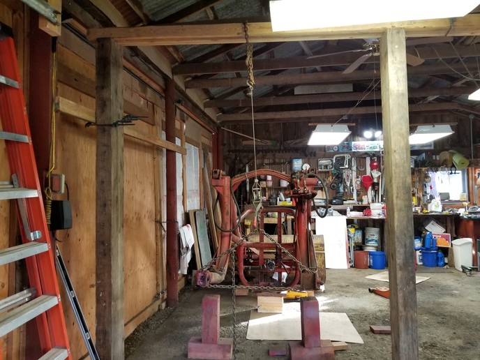

Tough question to answer I suppose but I am having a devil of a time removing the loader from the tractor. Any tips appreciated. I want to raise it and back out but the loader is so tight to the tractor that I can't back up far enough before the width of the loader frame conflicts with the width of the tractor drag links and stab arms.

I have a Superior loader on my 640 and when I took it off a while back I had to raise the back end arms up high enuf to clear the steering linkages. It was no problem[/quote]
My solution to removing the loader and putting it back
third party image
third party image
I know have a HF 1 ton chain hoist hanging from the Gantry crane setup with a cross bar leveling device for lifting the loader rear frame

Does your 640 have power steering? It could be that my steering cylinders are adding just that little bit of width that's causing me the angst

Which 2000? I take it you're saying you cannot raise the loader higher at the point at which it makes contact????

Actually a 2110. That loader frame work is so tight it's almost as though I might even have to remove the foot platforms before it's over. Thanks for your input.
