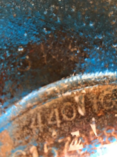

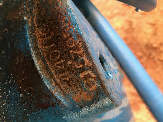

davehartman99
03-25-2018 13:53:35
Report to Moderator
 Re: Trying to figure out tractor I have in reply to Sean in PA, 03-25-2018 11:46:28
Here were the pics of the nums but hard to read
third party image
third party image
third party image
[Log in to Reply]  [No Email]

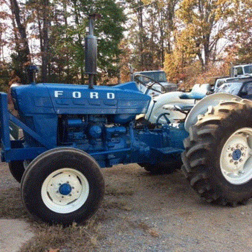

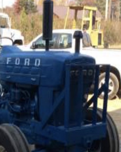

davehartman99
03-25-2018 12:11:09
Report to Moderator
Sorry for so many pics. Here is the same pics but clearer of the front if that helps
third party image
third party image

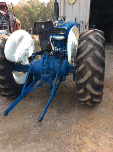

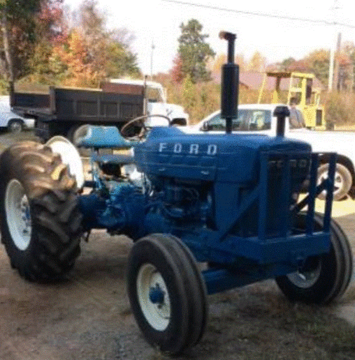

davehartman99
03-25-2018 09:31:27
Report to Moderator
 Re: Trying to figure out tractor I have in reply to Destroked 450, 03-25-2018 07:52:28
third party image
third party image
third party image
third party image
Ok, no ID decal under the hood. I don't think it is a 4600. It has a oil bath front air cleaner and is 2 foward, 2 reverse in low, 2 forward, 2 reverse in high. So 4x4 and I thought the second numbers were indeed a G and not a 6. That would agree with the G letter code you mention.
third party image
third party image
third party image
third party image
