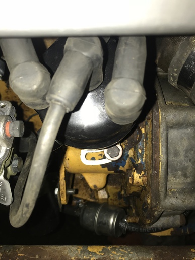

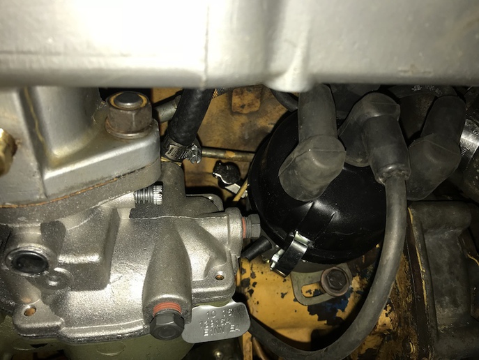

greymond
03-20-2018 09:27:11
Report to Moderator
 Re: boy do I need some help.. ford 3000 bucking and spitting in reply to greymond, 03-07-2018 14:26:48
I marked the flywheel to the left of the 0 mark at 10 degrees in order to see if the advance is working. It advances with the throttle going up but I can't go too far because it will cut out and die. With the timing light on the mark when I accelerate the mark bounces around and the light cuts out briefly.. Only at acceleration not at idle.
Also I pulled this resistor wire off the coil that goes over to the female in the harness by the generator. I had to cut and splice it due to it being damaged. It clearly says "do not cut and splice" on the wire. I shortened the wire and put on a new male end and tried that but it didnt change my problem
Could this cause this problem I am having?

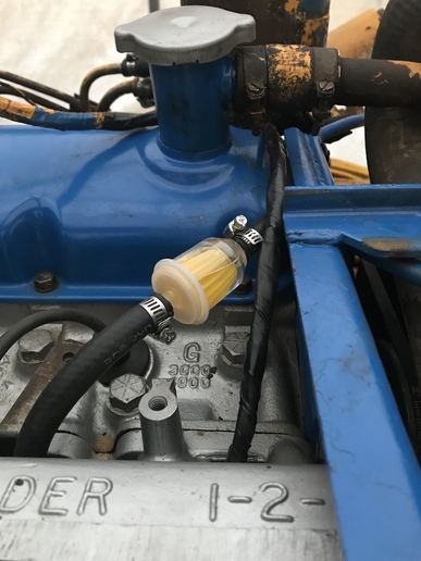

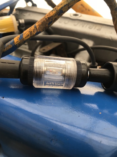

greymond
03-15-2018 18:40:32
Report to Moderator
pulled both filters and tested the pressure. Put both filters back on and tested the pressure. Tested dead on relative to the book specs.
That picture is after I shut the valve off, pulled the carb out
A starved carb would spit fuel out the intake? Never seen that
[Log in to Reply]  [No Email]

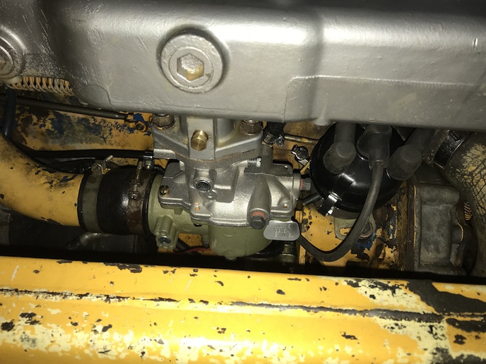

greymond
03-15-2018 17:48:25
Report to Moderator
It would be quite a surprise if this carb was faulty same as the other new one. Both new zenith carbs faulty? wow. I pulled the intake to see if there was a crack somewhere I couldn't see. Looked good so I have ruled that out. I also had an older inline pressure regulator and I installed that thinking that the gas coming out of the carb was due to over fueling. DIdnt do squat. I am beyond what to do next. Perhaps it is a second new carb that is bad.
I have never seen fuel coming out the intake of a carb due to an intake manifold gasket leak. I did rev it up to where it begins to buck and I sprayed starting fluid in there and it ran like a charm leading me to believe it is carb related.
keith williams
03-15-2018 18:27:56
Report to Moderator
 Re: boy do I need some help.. ford 3000 bucking and spitting in reply to greymond, 03-15-2018 17:48:25
How many times do people need to point out those non factory fuel filters and the fact that they may be limiting fuel flow!
Hobo told you to test that on 3-9 and you just did it today and you have proved that you are starving for fuel.
A carb can't provide fuel it doesn't have.
Look at the picture of that fuel filter. There is air trapped in it!
Blunt but needed.
Keith

greymond
03-14-2018 19:34:51
Report to Moderator
Okay thats good news as far as the coolant.
I am running the carb with the intake off. And I do put the tube on once in a while to see if there is any difference.
Below are a few photos. The rig runs the best and gets up to its highest RPM with the timing all the way to the slot on the right. But if I accelerate any more than 2000rpm it bucks and dies. The gas line is 1/4" with the two filters pictured. The fuel pump is new.
Any ideas would be great..

Sean in PA
03-14-2018 18:56:24
Report to Moderator
You should only add coolant until the core is covered by a half inch or so. If you fill the radiator any higher it will spit out coolant when it warms up.
As for your original issue, have you tried running it without the air intake hose connected to the carb? And have you checked the air intake all the way to the filter for any clogs, and have you tried replacing the filter?

greymond
03-07-2018 17:21:25
Report to Moderator
 Re: boy do I need some help.. ford 3000 bucking and spitting in reply to greymond, 03-07-2018 16:51:09
here are a few pictures of my setup... This dizzy is a mechanical advance. I eliminated my vacuum line and plugged the hole at the intake. I swapped the rotor and cap and nothing has changed. As soon as I accelerate to 1500 it will backfire spit and die.
