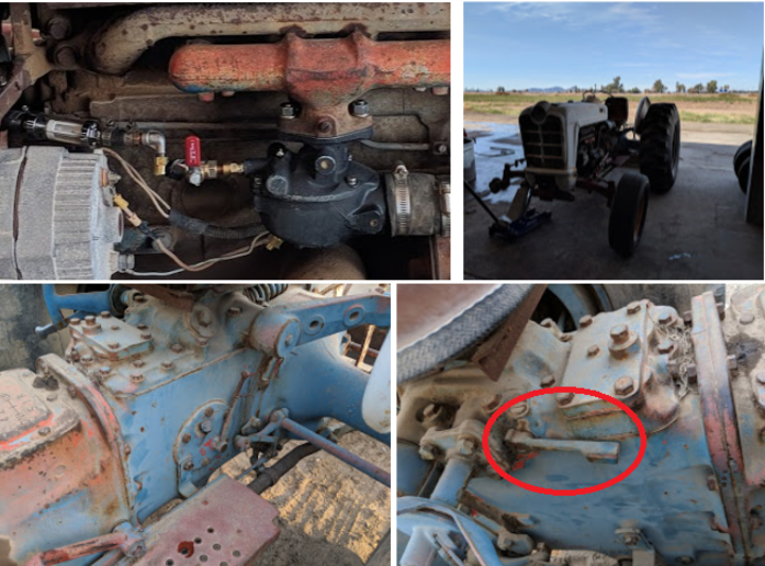

Ok, now sorry to keep this going, but I have a few more questions, thanks in advance for any replies.
1. In the image below, what does the lever circled in red do?
2. If I drain the rear end, does that drain the tranny also. If so, do they all take 134 hydraulic oil or today's equivalent? Same question for the power steering unit, is 134 hydraulic oil ok for it, or is it special?

Thanks for the glowing review Dan.
Glad to hear it's working out well for you! :)
The lever circled in red switches the hydraulics from draft control
mode to position control mode. In draft control, a ground engaging
implement like a moldboard plow adjusts itself. In position control
mode, the implement stays at the height where you set the
Touch control lever. This is where I keep mine 99% of the time.
On the later tractors like yours, the rear end, transmission and
hydraulic fluids are all separate. You can use UTF that meets Ford
spec M2C134D in all of them. Sold at TSC, WalMart, NAPA etc.
If the seals leak between them, there is no worry about them
mixing that way. Watch the levels though, so none get low.
A 10W-40 motor oil should work fine in your area I would think.
So would a modern 15W-40 or 10W-30.
