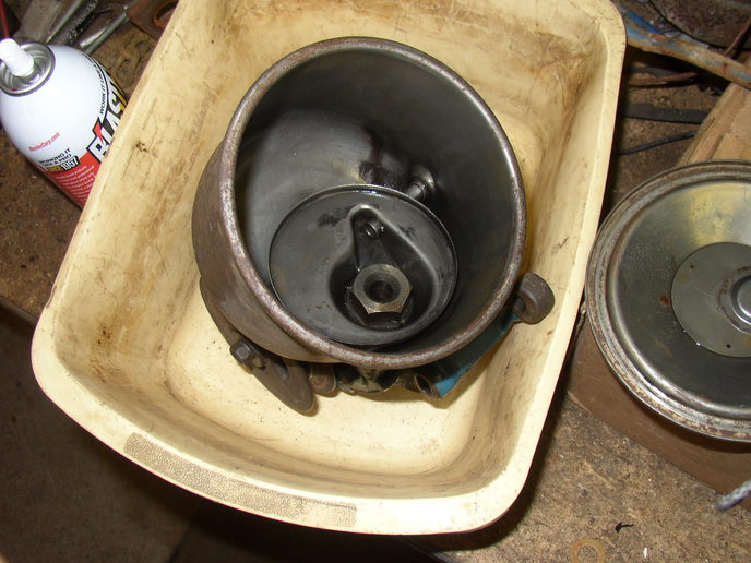

I have a '63 4000. Today I started to clean up the power steering pump. It has been sitting in a container open, and up side down draining.

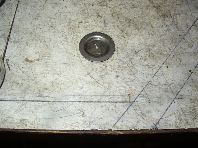

I went to clean it, and surprise, there is no filter in, and nothing to hold the filter in. Is this something I can just make up, or is there something special to the bolt that holds it in. Plus a small steel disc was in the bottom of the drain container. What is it from, it came from inside the reservoir?
Thanks, Pat

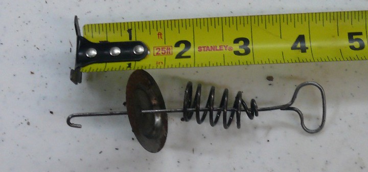

Here are some pics. I posted earlier this year to help someone out.
Maybe help you out too.
The hook goes in the hole, it will catch on a lip about 1/2 " down
the hole. The filter I have is 3" dia. 1 3/8" thick with a 1" hole.
If you make one be sure you have plenty of tension on the spring.

I think that it's supposed to hook onto a lip on the inside of the big nut at the bottom of the reservoir.

The hook on retainer went down thru hole in center of hex. That bolt is cut down on od of bolt so bail can catch on it.

That disc hold the filter against the little cup in the bottom. You essentially won the lottery as that is usually missing. You can McGyver a retaining spring that reaches through that disc and hooks to anything you can find, or fix a thin bolt to something that then will poke through that disk and take a wing nut.
