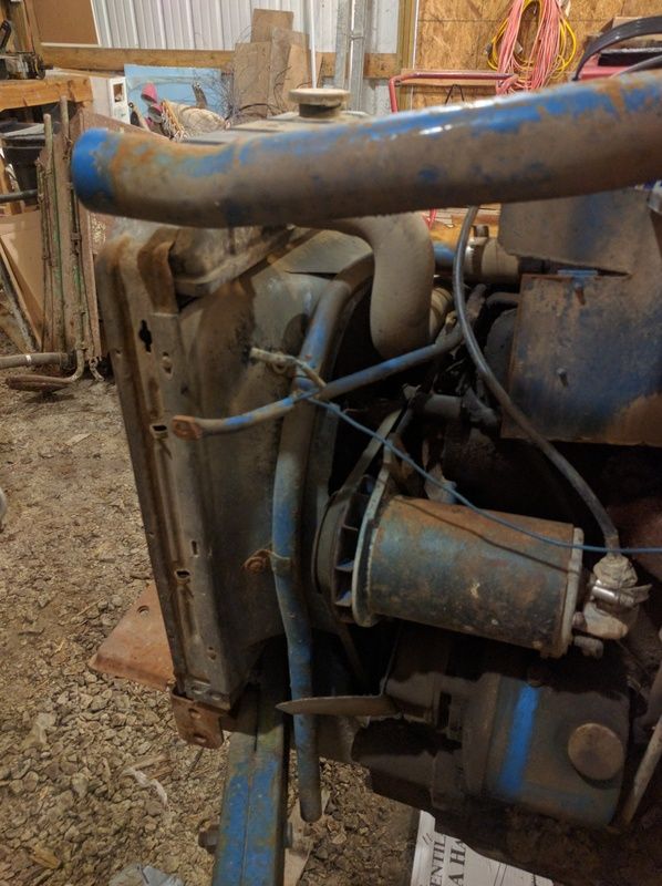

Good morning folks. I have a 1975 3000 gasser that I'm starting to repair to get back in to good working order. First thing... I don't believe the radiator is mounted/secured properly. I can actually reach in there and push it back and forth quite a bit. Is there a radiator mount/support that is supposed to keep it from moving? I dug into it a few weeks ago during a thermostat and cap swap, but didn't see anything that looked missing.
If you have pictures of the part installed and/or part number that would be great. Thanks in advance.

 Re: '75 3000 radiator support/mounting in reply to kswLS1, 08-18-2016 05:52:12
Quoting Removed, click Modern View to see
My 4000 was originally a gasser and I converted it to diesel, still have the gasser vent tube on it.
While you have the front off it would be a good time to weld or strap that crack in the shroud before it breaks into and gets into the radiator cores.
A lot of support comes from the crankcase vent attachment to the shroud.
Here are the pics -
The front of my tractor is open now because my daughter ran a round bale into the tractor while moving and bent the shroud. So, the covers are off but all of the rest of the stuff is intact. I will take some pics in a while and post them. Its a 2000 but the mounts are the same.
The brace from the head goes to the grill shell not the radiator shroud, other than the bottom two bots these radiators are pretty much free standing.
kswLS1: Something I just remembered, gasser engines have a crankcase vent tube coming from the valve cover that bolts to the fan shroud in two places and vents on the left side of the engine. Diesels vent tubes attach to the timing cover and vent to the right side. This vent tube helps prevent radiator movement better than the short upper hose a diesel uses.
Check where the vent tube bolts to the shroud and also check the short rubber hose and clamps that connects the valve cover vent to the vent tube, also make sure the shroud is attached firmly to the radiator.

Ditto what Destroked said. The two bolts that mount the radiator to the frame are carriage bolts. The heads of the carriage bolts are held in place in grooves in the bottom of the radiator, so you don't want to over-tighten them and round out the slots that hold the heads in place.
Top radiator hose is critical to keep the radiator from rocking forward to back.

Some back and forth movement is ok.
Radiators on these tractors mount to the tractor with two bolts in the bottom corners of the radiator and normally have a thin rubber pad between the radiator and tractor chassis, make sure these two bots are not loose but do not over tighten, just nice and snug.
The top hose helps to stabilize and limit the radiators movement, check the condition of the top hose and make sure it has a factory style molded hose, not a aftermarket flexible hose.
