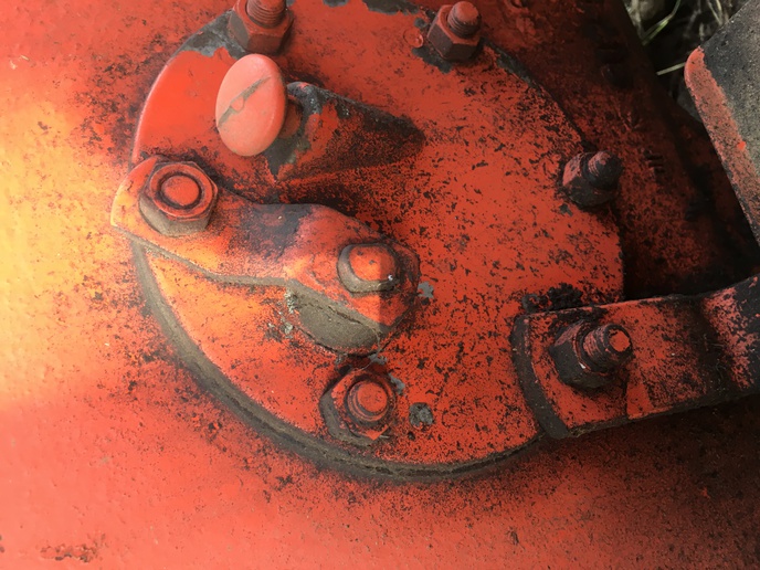

Larry NCKS
08-19-2016 22:22:56
Report to Moderator
 Re: Ford 601 select o speed help! in reply to Allenstone, 08-17-2016 17:46:03
That's it. The paint on the little strap would tell me that the eccentric is in the engaged position. I'd want to take that round cover off (you may lose fluid from the hydraulic section, but it sounds like you need to lose it anyway) and get a good look at the TD coupler itself. Visually confirm whether it is in the engaged (transmission tailshaft to pinion shaft) position. It is possible for the eccentric to have been rotated too far and become disconnected from the TDC.

Allenstone
08-19-2016 20:38:57
Report to Moderator
[img] third party image[/img] ok got the pic up!
[Log in to Reply]  [No Email]

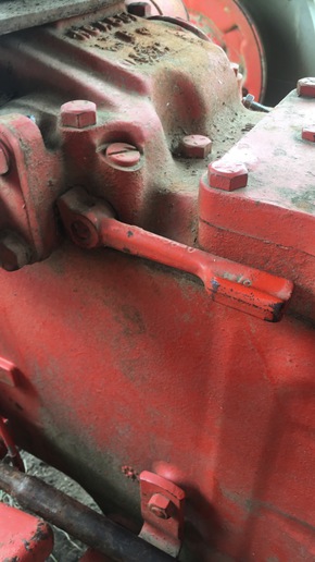

Machnegative
08-18-2016 19:13:27
Report to Moderator
Quoting Removed, click Modern View to see
That is the lever for draft/position control for the 3-point lift. Horizontal is position, down is for constant draft.

fredstev
08-18-2016 19:13:21
Report to Moderator
No, other side (left) by your left heel as you sit on the tractor. Round plate with a dipstick and a funny looking stamped lever next to it. Ain't rocket science, is it engaged or disengaged? if disengaged, tractor is free to roll around. If engaged, tractor has to be running to put it in neutral and move.
Looks like the top cover has been left off and tractor parked outside. Does not bode well. . . . . .

Allenstone
08-18-2016 18:58:57
Report to Moderator
I'm assuming this is the td

Larry NCKS
08-18-2016 17:34:33
Report to Moderator
What position was the TD in before "it hasn't been tampered with"? I'd want to "tamper" with it enough to find out whether it's engaged or not, anyhow. If worse comes to worst, take the inspection plate off and look to see if the TD is engaged to the rear axle pinion shaft. If the TD is connected and the tractor rolls with engine shut off, you've likely got worse problems than are economically feasible to deal with given other unknowns.
As to your hydraulics, if it's set for awhile with water in it, it's anybody's guess what valves are hung and/or what shape the pump is in.
