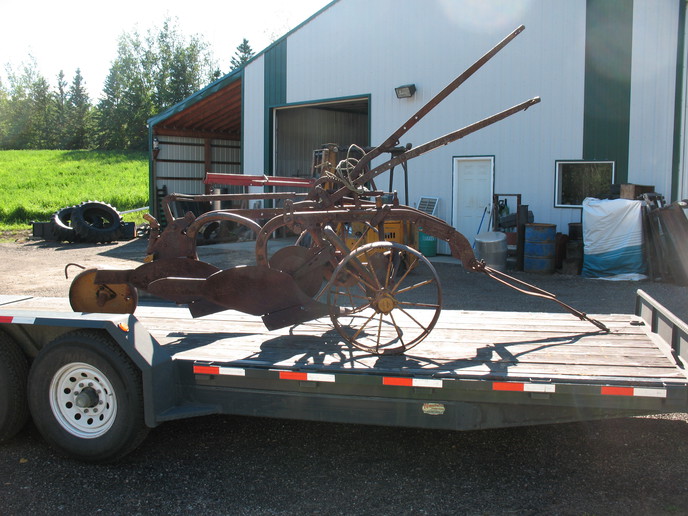

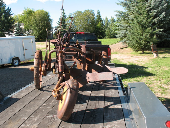

Well maybe this time, I don't get it I upload them and they show at the bottom then proof gone just text in the post
The two big parts laying across it are unrelated, they are backhoe subframe mounts for a ford
Thanks Mark, 3rd time's the charm.
So those 4 bolt pads are for U bolts over a square axle/fender mounts right.
The front looks like it mounts to the front bolster like Sean said but does it use a bracket?

From Mark's first picture, it looks like the pads on his for mounting to the rear axle slide in and out of the main loader frame and might allow it to fit the length of the 2000/3000 as well as the 4000 without having to use extenders like my Freeman loader does.
I can't tell how his mounts to the front of the tractor, so maybe that's where you'll need different brackets between the 3000 and 4000.
No it's all rigid no sliding, definitely
would need modification but would likely be
a better start than the Wagner, and look a
lot better when done
