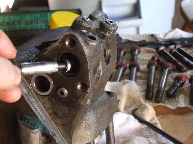

Working to get my Jubilee hydraulics up and running. I have multiple problems I'm working through. One of the problems caused me to buy a new lift cylinder from an eBay seller. Neither the 'new' lift cylinder or my original lift cylinder had a unloader valve with the O-Ring present. Nothing there. Not even debris, residue, nothing.
Q1; What the heck happens to the O-Rings?! Hydraulic pressure chew them up and spit them out?
Q2; Are the Unloader Valve O-Rings necessary? Some say to make sure you get the New Holland O-Ring or you'll be sorry. Were/Are the missing O-Rings non-New Holland?
Q3; Where does the O-Ring go? The parts breakdown implies the O-Ring goes over the shortest stub at the end of the Unloader Valve. I would appreciate confirmation that indeed it goes as shown below.
Verus this:
Q4; I have no desire to redesign the Jubilee hydraulics, but it's real hard to see what the O-Ring does! <rhetorical question>
Appreciate the help!

Most O-rings are synthetic materials. Such materials deteriorate with time even if not a wearing item. Design engineers rarely specify unneeded parts.
Do yourself a very big favor and buy the proper O-ring from CNH.
If you do the job properly, it is likely that your grandkids will not need to do it again.
If not, you will likely be pulling the lift cover within a few months.
Dean
I do not have a clue what you have there! All I know of used rubber/synthetic O-ring, except some early hundred series & they used a steel ring like the one pictured. The NAA would look just about like that but have the O-ring in the same place that the steel one is here.
It sticks in my mine that the first NAA's had an unloading that was metal to metal with no o ring. That pictured could be the valve .The pictured o rings are somebody's nonfunctioning afterthought. I believe this system was replaced with a valve, with a o ring in a groove fitting into the original bushing in the cylinder housing

In almost all discussions with regard to non-functioning NAA hydraulics, somebody will recommend ensuring the unloader valve is cleaned up and does not stick. And wears the OEM O-Ring. Does anybody have a picture? Seems everyone overhauls this part - perhaps a picture of this beastie exists.
Meanwhile, I've found a Ford promotional video that shows hydraulic fluid flow through the system. The valve I picture above most resembles the valve Ford calls a By Pass valve in the video. The video has no such valve labeled "Unloader Valve".

Follow the dashed line of #6 into the cylinder. Is that where yours came from?
(quoted from post at 07:38:34 08/07/15) Follow the dashed line of #6 into the cylinder. Is that where yours came from?
AHA! Yes - same bore, just different part... WayneIA mentioned there was a 'old style', and I am jumping to the conclusion I have the old style - my actual Unloader Valve is pictured at the beginning of the thread. So my original Unloader Valve was the old style, as is the replacement that came off eBay pictured. Thank you JMOR for posting pictures.

As promised, here is the apparently early Parts Book page that shows the original Unloader Valve. Same as in this thread's first post.
A couple of take-away points:
1) New Holland's online parts book may not show you the 'early' versions of some parts.
2) There was no O-Ring on the early style of Unloader Valve - so no mystery as to where they went. They weren't there in the first place!
3) Early styles were/are rarely the 'more reliable' versions. Gotta wonder how this will play.
