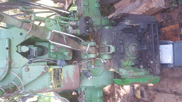

Then we spent close to an hour trying to get the gas tank off because it was leaking pretty bad (where the fuel line connects into the tank). You can't see it very well, but there's a rubber segment in the fuel line (you can see it in the bottom left of the picture)
third party image
I think that's a patch or repair, but dad thinks it may be factory. Either way, doesn't seem to be leaking around it. If I wind up needing to replace the fuel line, do I need to be sure that rubber elbow-like piece is in it?
Here's a close-up of the manifold (muffler fell right off this side)
third party image
It looks like the piece that's sitting on the manifold in the pic has broken off the bracket. Should there be a "lip" on the manifold that I'm missing?

That's not the factory fuel line as Texas! said.

Your exhaust elbow is broken, they sell them here on YT.
They bolt on with two bolts there on top of the manifold.
As rusty and horrible as they might look, mine broke right off
and came out easily so I could replace them.
Hopefully you have the same good luck!

That is not the factory fuel line.
Your exhaust elbow is broken. You will need to weld it back together or get a new one.
