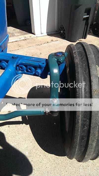

Hi all. I've got a '72 or '74 Ford 3000 3 cyl diesel. I installed the power steering kit found here on YT catalog (http://www.yesterdaystractors.com/Ford-3000_Power-Steering-Kit_S60747.html) and I've got a couple questions. I'de appreciate any input anyone can provide.
First, a pic of the overall install:
The first issue is with the left pitman arm:
As you can see, it's right up against the left tire and rubs. I'm not sure how to correct this as where the pitman arm connects it's keyed and I don't know if it can be clocked to a different degree. Notice the next picture of the right pitman arm. There is plenty of clearance.

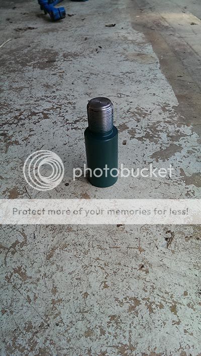

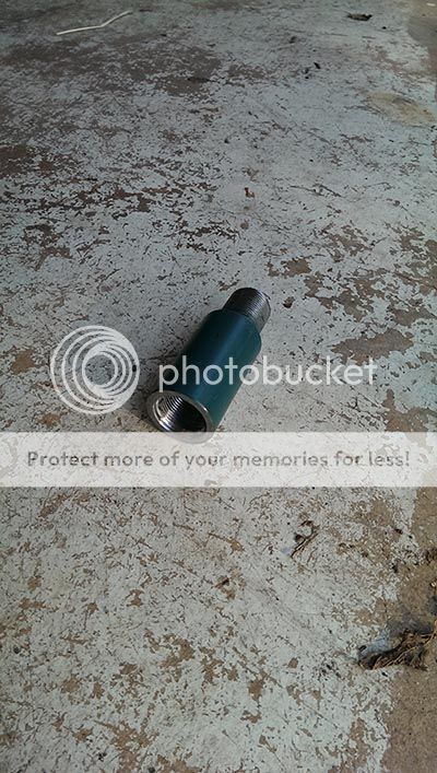

Next I have an extra part!! I have a decent guess on what to do with it but I'm not sure since where I think it goes... I just don't see how to install it.. The next two pics are of the part.
The installations instructions were extremely vague. They were clearly written for someone that at least SOME knowledge tractors. I'm not that someone. To make matters worse, that part isn't even shown in the single install diagram, which can bee seen at the link in the beginning of this post. On the parts list, there is only one that isn't represented in the diagram, and it's labeled "gear box arm".
So, I'm assuming it's used to extend the shaft (1) coming out of the steering gear box that the left seering arm(2) is connected to. See the next picture for references 1 and 2.
I assume the shaft needs an extension since when I turn full left turn the steering arm will hit the PS cylinder. That extension would presumably let it clear. Just looking for confirmation of this before I go buy a puller tool to remove the steering arm.

1, I can assure you that lil piec eyou see is NOT to extend the sector shaft out. that sector arm is SPLINED.. how do you soppose you'd conenct a splined arm to a smooth adapter?
2, in the front tire / clearance issue.. have you considered dishing your rims?
3, how much interference is there with the steering sector arm and the hyd cyl ball end? is it real close.. like so colde that a lil smooth sided externder piece a couple inches long would make a difference?

Thanks for the reply.
1. Good to know. I suppose you wouldn't. Without a proper puller tool to remove the sector arm there's little way for me to know it's splined. Removing the nut from the end of the sector shaft only revealed threads and nothing more. So, having a part that is presumably labeled a "gear box arm" that has both OD threads and ID threads, and having a sector shaft coming form the steering gear box that also has threads(at the time not knowing there are also splines beneath the sector arm), it's not a far fetched conclusion of mine that that's where it may go. Especially given the fact that the sector steering arm hits the hydraulic cylinder. I assumed it was 'keyed' in some form or fashion, but couldn't investigate fully without the tool. Thanks for saving me the hassle and cost of acquiring the tool.
2. I haven't, but then again I don't really know what that means. I'll look into it.
3. that lil smooth piece is about 3 inches long, not including the OD threads. So, yes, it would make enough difference so that the sector arm can clear the hydraulic cylinder.
I'm at a loss at where that little part would go. the diameter of the threaded portion is way bigger than anything on the tractor where the steering system is concerned. the threads are at least an inch in diameter, maybe bigger.

the sector arm is for sure splined.. the splines are visible as their dimensions are larger than the diameter of the threaded shank the nut is on... think back to your physics classes. there is no way the splines are a smaller diameter than the threaded shank.. otherwise the arm wouln not be able to be removed!..

i've attached 2 pics to this post. one is of a steering box.. not the one on a 3000.. but will show you the size difference inthe threaded to splined diameters.. the next is a sector arms
I agree with Rod - return the kit. Near as I can tell, your front tire offsets are the same, and to have the steering arms that different from each other with regards to tire clearance would really concern me. The quality of those castings look pretty scary to me too. I'm sure they're China's finest.
My only departure from Rod's advice would be in looking for a factory PS setup. While it would be better than what you have, myself, I wouldn't own a 3000 anyway, because of that front axle and drum brakes. Find yourself a 4000 and be happy with life.

If you were good with a torch and welder you could heat that left steering arm with a rosebud and bend it inward a little. Then then shorten the tie rod that goes across from left to right.

Intall a washer on each lug bolt behind the rim on the left tire. this will move it out just enough to give you the clearance you need.
Secondly the extension does not fit the steering rod to extend it a bit for centering the cyl between left and right turns?
In the earlier models of the power steering add ons, I have seen the steering cylinder reversed and the rear mount at the engine was in two models, short for 3 cyl fords and longer for 4 cyl fords. So I was wondering if you reversed the cylinder?
