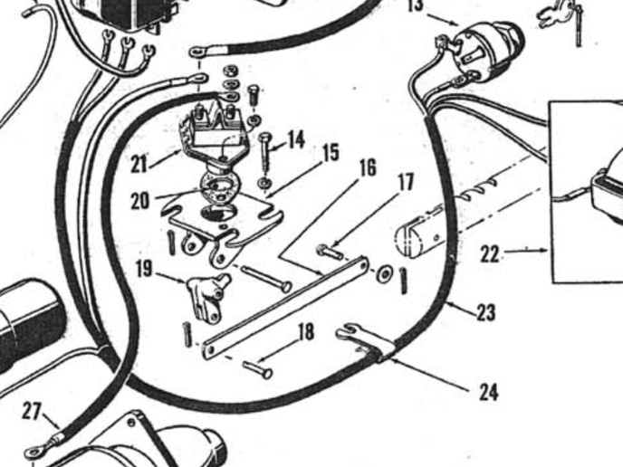

Tom H.
11-11-2023 05:44:32
Report to Moderator
 Re: Starter Solenoid in reply to Joe TO Fan, 11-09-2023 17:49:45
Heres a picture out of the parts manual showing the shifter operation starter. Hopefully you still have the mechanism in the tractor. Let us know.

Joe TO Fan
11-11-2023 10:41:36
Report to Moderator
 Re: Starter Solenoid in reply to Tom H., 11-11-2023 05:44:32
Obviously I don't have most of all of those pieces you showed me. I wondered what was that big blob was for. So now I understand what many talk about. I have no idea why someone would get rid of it all. Looks to me that would work better than what I have.

Tom H.
11-12-2023 06:55:16
Report to Moderator
 Re: Starter Solenoid in reply to Joe TO Fan, 11-11-2023 10:41:36
Quick question, whats left? Did someone cover the hole? Is the linkage still there? The safety feature of the shifter start is you can never start in gear.
Let us know what you have so we can help . You may have the linkage there and just need to put it back to original.

Joe TO Fan
11-12-2023 09:15:05
Report to Moderator
 Re: Starter Solenoid in reply to Tom H., 11-12-2023 06:55:16
It's all gone. Only the part that coverers the hole'. The linkage is gone. Safety feature of the shifter start gone.
As an note of interest is I have owed it for at least 10 years. Since the stuff is gone, I've never seen any of that stuff. I noticed by others talked about all that and always wondered I didn't have it.

11-09-2023 19:59:08
Report to Moderator
TO20 did not have a solenoid as delivered from factory . They did have a starter switch activated by the shift lever.
