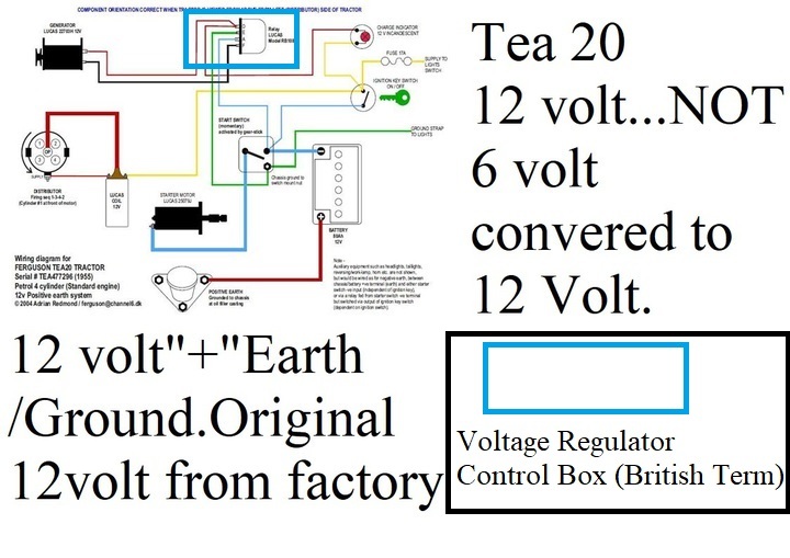

I just had my 12 volt generator on my Ferguson TE 20-85 fixed and rebuilt. The amp gauge shows that it is working. However, when I run the tractor for 30 minutes or so, the battery runs down. This did not happen when the generator wasn't working (before rebuild). Anybody know what's going on here?

Thanks for these diagrams. It will make my search easier
[Log in to Reply]  [No Email]
John Deere D
11-08-2023 10:13:26
Report to Moderator

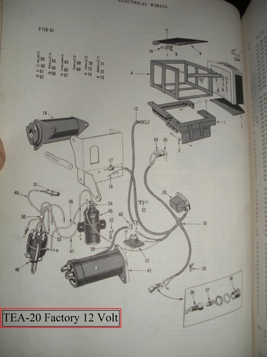

 Re: TE 20 Charging issue in reply to claresutton56@gmail.com, 11-07-2023 06:00:51
Wiring Schematic...
Third Party Image
Third Party Image
The generator has to be polarized for it to charge. The regulator has to have a good ground with no voltage drop (make sure all connections are clean between the battery, regulator and generator)
See: When and how to polarize a generator.
