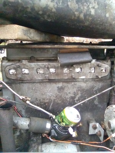

Manifold was shot. 3 holes once you poked the rust. Hole on #1 was so bad didn't notice other two holes. New manifold on the way. Shopping high temp paint, and getting new hardware for manifold and gas tank.
Some of the manifold washers seem to have been copper? No lock washers, are they needed? Don't see any in Fergy IPL/Parts manual. Debating on SS or brass nuts/washers for manifold.
Good news is head surface and studs are in good shape. Cleaned up with a paint scraper/razor blade and some cloth backed 80 grit on a hardwood sanding block. All set when manifold gets here.

6 of 8 of the manifold nuts you can't get a socket on. You not only need to disconnect the carb to remove the manifold, impossible to get at the bottom nuts with carb in the way, need to use a box end. Same for the top ones except for those need to remove the gas tank, glad it was nearly empty. Box end only, not room for an open end.
Two "Hillbillys" on the gas tank mounting bolts (5/16") . One was a 5/16" battery terminal bolt , had the square head, another was 1/4" and had an additional 1/4" washer/nut to hold it. The bolt mounting holes are threaded 5/16"
I'm replacing all the nuts as they were probably on there since I was a child. ~1/8-1/4 turn at a time, with the box end almost until they came all the way off.
So no way to torque the nuts. I have both a 52 and 73 updated versions of the Fergy shop manual. No info in those for tightening sequence, nor the IT manual.
Now the best part, not only was gasket shot, but a few holes in the manifold, #1 and #3 exhaust. Looking for a new manifold.....one picture shows the hole in #3 ex.
And one of the manifold nuts fell down the ex pipe..... ....
