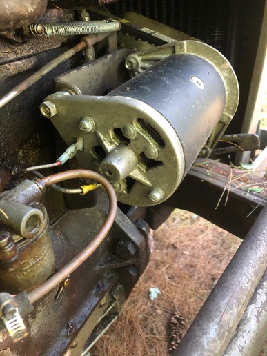

A 30-amp ammeter will be best with that generator.

You can tell a generator or alternator by measurements, at least from all I have had, A generator will be longer than it's diameter, the alternator is just the oposite. So try to give us the measurements of the housing, that is what a picture would give us to go on. I am familuar with the TO series for USA sales, not familuar with the TEA series for England so where the TO only had from factory a 6 volt system the TE being made for the english market may have had a 12 volt system and the guage readings says that is probable was a 12 volt and not a 6 volt like here in the USA familuar with. Is your battery now a 6 volt or 12 volt.

Andrew Davis
10-20-2023 09:28:00
Report to Moderator
 Re: Amperes guage for TEA 20-85 in reply to Leroy, 10-20-2023 07:41:51
It is a generator Third Party Image

Orignal would have been the 30 and will give you a better reading if generator, 60 only if converted to 12 volts.

I believe the original was only 15 or 30 amps as those are more common generator outputs. 60-amp meters became more common with alternators which typically have higher outputs than generators. Do you have a generator or has it been converted to an alternator?

Andrew Davis
10-18-2023 16:21:19
Report to Moderator
 Re: Amperes guage for TEA 20-85 in reply to Jim.ME, 10-18-2023 15:32:00
I believe I have an generator. Can't figure out how to move the picture from my photos to this post.
