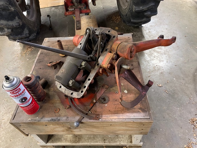

pomester
10-20-2023 15:50:34
Report to Moderator
 Re: To30 hydraulics in reply to ruschman, 10-18-2023 11:27:09
"I could raise the lift arms manually without resistance. Once raised, they fell rapidly back down with no resistance."
That is because the arm mechanism is not attached to the piston/rod assembly. It's a one way cylinder/piston using gravity/weight to lower the lift arms. When you raise the arms manually you do not move the piston.
A couple of pictures of the mechanism. This is an 8N cover which I used to covert a TO-30 to position control, but the cylinder/dog bone/lever are of similar design to the original. The dog bone is attached to the lever, but not the piston in the cylinder.
Third Party Image
Third Party Image
Third Party Image
[Log in to Reply]  [No Email]

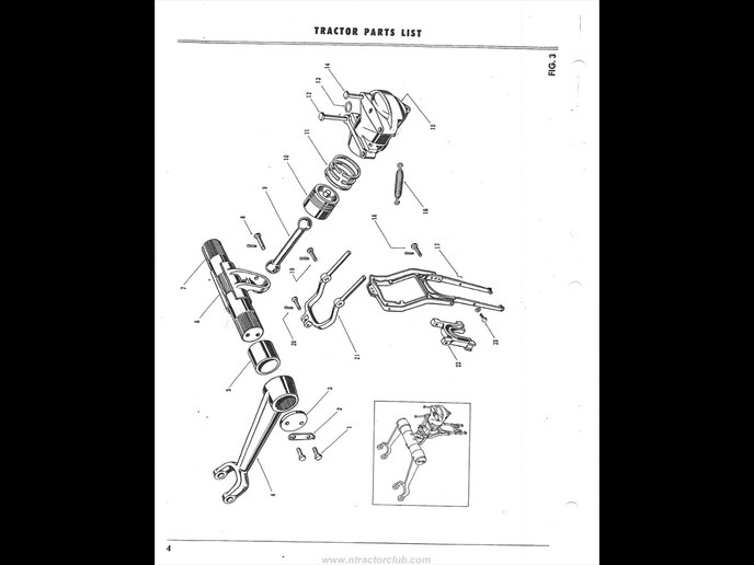

Tom H.
10-20-2023 05:42:52
Report to Moderator
 Re: To30 hydraulics in reply to Bruce(OR), 10-19-2023 09:26:20
Follow what Bruce says looks like a good plan. It may be that the lift arm pistons O rings may have worn out too. Third Party Image
