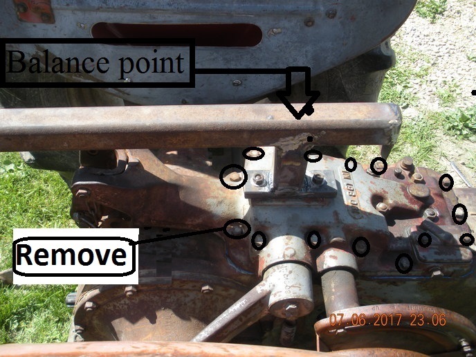

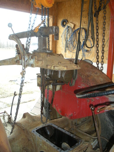

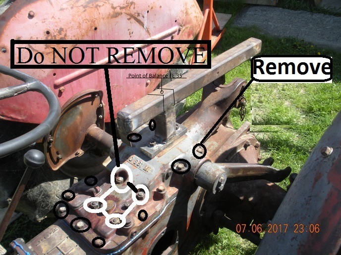

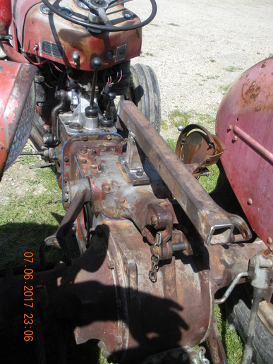

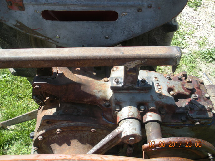

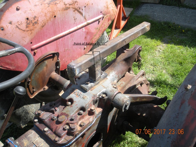

This JIG is used on my 2-N...Ferguson TEA-20 and MF 35 X

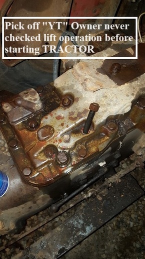

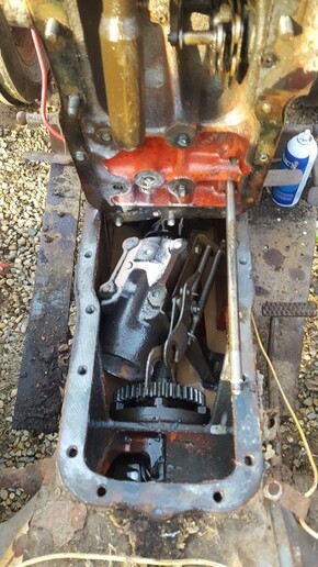

 Re: Early TO35 Hydraulic Pump and Cracked Lift Cover in reply to Dtractors, 10-15-2023 13:57:08
I was on mine when it cracked the lid and case. Don't recommend being in that position when it happens. Oil shot between my legs and over the hood. Could have been straight up. Took 3 yrs but found complete used rear end. Suggest you replace pressure release valve and consider a new hydraulic pump. Had my old release valve tested. Would NOT crack open at 8000lbs, was supposed to operate at 2000lbs. I purchased 3 relief valves before I found one with lowest setting of 2700lbs. Had all tested. All were advertised for TO35 and 2000lb relief point.
