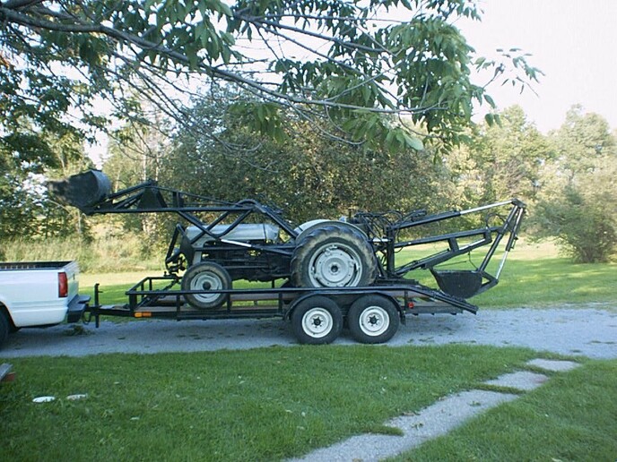

Hi Ed,
I ran across some old postings about a Sherman backhoe you have on a T030. I've picked up a Sherman 54C and would be interested to see some detailed pics on how you modified yours to work without using the original subframe.
I've got the original subframe, but would like an alternative that would be easy to mount and dismount so I'd still be able to use the tractor for other 3 point duties.
Any detailed pics of how you reworked yours would be very much appreciated.
Thanks!
Paul

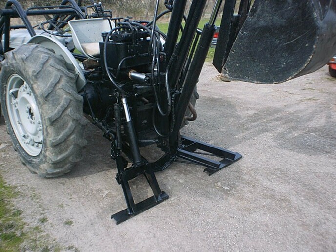

 Re: Question for Ed H.-OH about Sherman backhoe on T030 in reply to paul25g, 01-13-2022 11:30:06
Paul, Thank you for your reply, A lot of people don't bother....I have a 2000 ford, looked at it and you cannot connect to the top link as i described, Fords top link is weak and it doesn't have the long pin under it like the ferguson..sorry....Ed

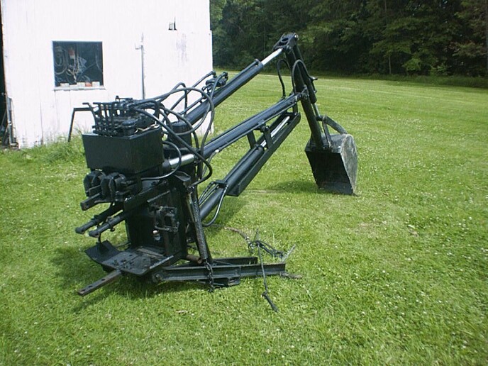

Paul, Hello, And thank you for your interest...My tractor is a to 35. And the backhoe is a 1954 sherman mod. B.. Made in Michigan by Wayne-
Roy...They Patented and made the first backhoe...A piece of history. .construction went from pick and shovel to operators....If you look at the rear of the hoe setting on the ground you will see a draw bar tongue welded to the sub frame, That goes in the hitch under the pto ,and is the lower mount, there is an eye at the top that hooks directly in the top link pin, Then you will see to sliding adjustable pipes that go in the long pin on the back of the tractor below the top link, I have long hyd. lines from the tractor and can put pressure to it on the ground and bring it up into place to connect to the tractor,3 pins and its mounted...I have watched my son digging stump roots with all 4 tires on the tractor off the ground and the tractor hanging off the backhoe...I can take better close ups if your interested..Hope this helps you.....Ed
[Log in to Reply]  [No Email]
