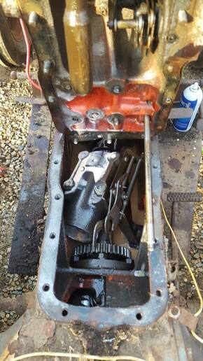

I have a TO35 that has a busted lift cylinder. Part number for it is 180967m1. It's a 2.5" cylinder. Does anyone know if I can use a later model cylinder for this tractor ? It's a 3" and instead of studs going through with a nut this one is tapped and uses 9/16 instead of 1/2 bolts. I found specs online on the bolt pattern and it seems the same as what I have . Part number for later 3" cylinder is 184442m1. From what I've read I think I can use this cylinder as a replacement but will need to open holes up on top plate and obviously get a new piston. Can anyone confirm if this idea will work ? Finding anyone with the cylinder I need in stock is proving to be impossible so far.

You might make it work, but I would be afraid to do it.
Very likely to break the top cover. Sometimes a broken cover can take out the case also.
And there are no 2000 PSI relief valves to be found.
Best option is to find a later model top cover.

 Re: TO35 Lift cylinder in reply to Jferguson5959, 02-11-2021 10:06:34
Good day Jferguson5959..
First off, I'm not a MF trained Technician..
Secondly, I own the Original MF 35 X that my parents purchased new in 1963...and have performed all maintenance..
In the late 1970's a neighbor was moving ROUND BAILS of hay on the rear lift of his 1962 MF 35.. As the tractor crossed a rough spot in his field....the TOP COVER of his Tractor split crossways and he was injured..
I would not and have refused to install new HYD PUMPS with the 2500 psi relief valve in / on Fergusons.... MF Tractors that are not equipment with the heavier top cover...
I believe this cover was from a Ferguson TO-35 that was not set up properly...as in MAX LIFT ..
All the best Bob..
[Log in to Reply]  [No Email]
John Deere D
02-11-2021 12:33:41
Report to Moderator
 Re: TO35 Lift cylinder in reply to John Deere D, 02-11-2021 12:20:17
I forgot to mention....
...FORCE =P X A .....3" Diam. piston = 7.06 sq inches .....2.5" Diam. piston = 4.90 sq inches....
The original TOP cover could very well NOT stand / fracture given the FORCE that is capable of the lift now with the 3" Diam Piston..
Bob ... (No guaranties on my math...........:))
