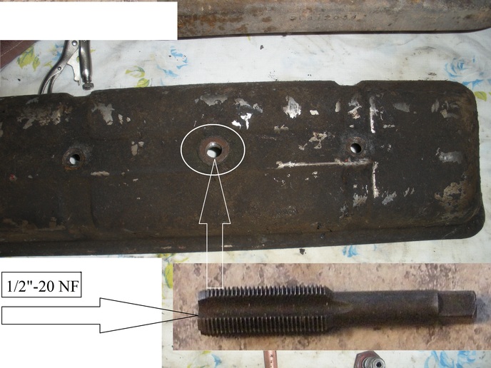

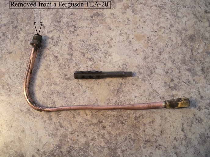

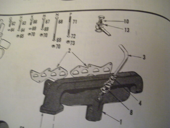

 Re: TEA 20 Tappet Cover Vent Tube in reply to Waudby, 01-13-2021 07:24:24
As per picture.
Copper tubing.
Bob..

John Deere D
01-12-2021 13:13:37
Report to Moderator
 Re: TEA 20 Tappet Cover Vent Tube in reply to Waudby, 01-09-2021 07:54:38
I have a spare "TUBE" as per picture.....
I would send you the "TUBE" at cost for shipping....Canadian Postal..
Tube is an original......flattened so as to provide proper clearance due to fuel tank and manifold..
Both of my spare parts Tractors have been robbed of the mechanism that attached to Rocker Cover..
Bob......Dawson Creek BC Canada
If interested send me your mailing address.....
[Log in to Reply]  [No Email]

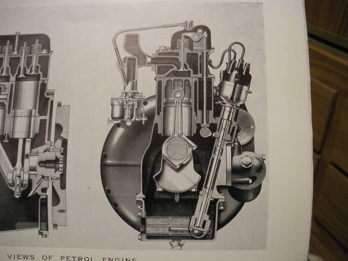

Charles in Aus.
01-11-2021 21:48:48
Report to Moderator

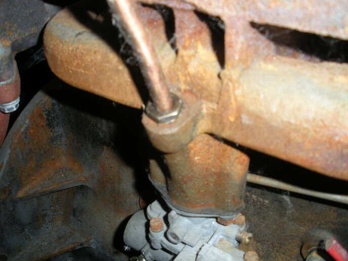

Some photos of the valve , there are two sorts one early one later , the principle is the same .
Charles in Aus.
01-10-2021 22:45:30
Report to Moderator
It is not a Schrader valve , but rather a jiggle pin the diameter of a paper clip passing through a small hole just larger than the pin in a small copper or brass disc a size smaller than that of a one cent coin .
The hole and pin restricts flow of gas while the pin keeps the hole clear of carbon . It is a complicated little device , you are doing the right thing to replace it as idling is atrocious without one .
