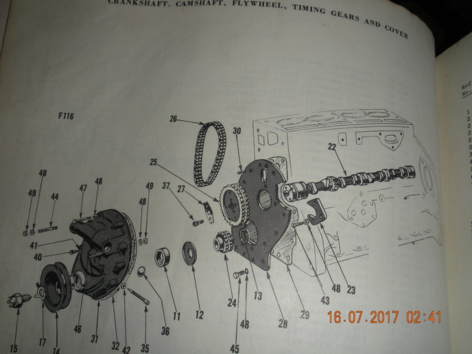

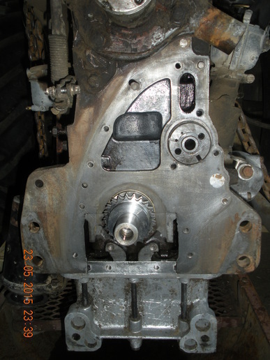

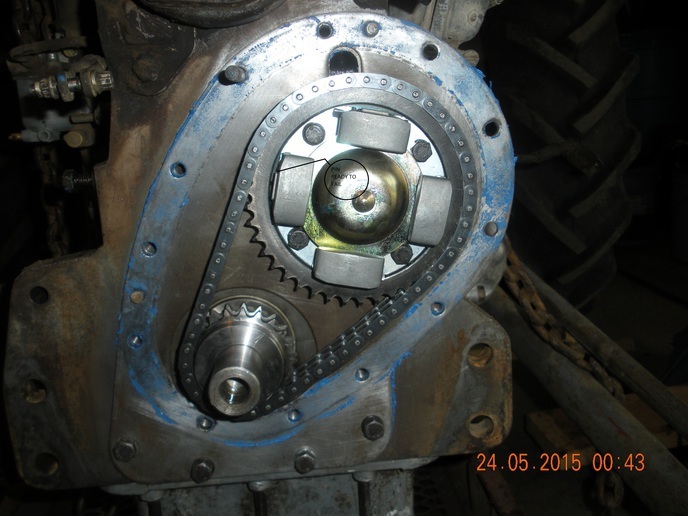

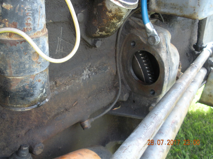

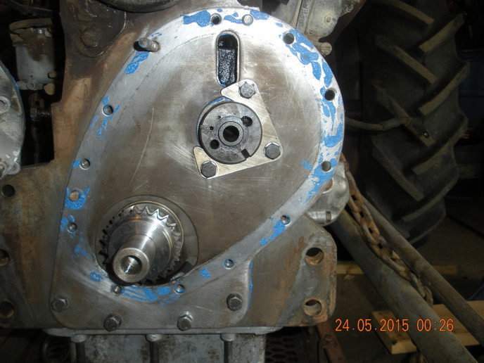

John Deere D
01-06-2021 08:27:56
Report to Moderator
 Re: Ferguson TEA20 running bad, backfiring, wont rev up.help in reply to Oltrubridge, 01-02-2021 11:47:31
At the end of a 12 inch ratchet,(attached to crankshaft)I noticed the ratchet would move 3" between Clockwise and counter clockwise before the rotor would move.
The ROTOR DRIVE on my TEA 20 S#182991 (6 Volts)was sloppy and the rotor was starting to contact the CONTACT points inside the Distributor CAP. I replaced the BALL Bearing assembly (inside the distributor assembly) and the amount of side movement / slop of the rotor drive is now nothing.
On my second TEA 20 S#251562 the drive TANG on the end of the DITRIBUTOR shaft was so badly worn it would misfire. . Please note.
The DRIVE TANG on the end of the DISTRIBUTOR on all three of my TEA -20's is OFF CENTER. The drive key way on the GEAR DRIVE matting with the CAMSHAFT is also off center.
One of my TEA-20s had a terrible lose of power as well as backfire.....
The timing chain sprockets were so badly worn the timing was way out.
With the STARTER REMOVED, I rotated the Crankshaft (CCW..CW) the TEETH on the FLYWHEEL showed no movement until the end of the 12" ratchet had moved 3".
Timing Chain and sprockets were totally thrashed.

John Deere D
01-06-2021 08:45:16
Report to Moderator
 Re: Ferguson TEA20 running bad, backfiring, wont r in reply to Oltrubridge, 01-06-2021 05:28:02
If the timing chain and sprockets are as bad as I have seen ....when the flyweights fall off the Governor disc, jam into the timing chain...it's going to cost you money.
Your Tractor, your $$$$$'s.......I would check the backlash on the timing Chain, sprockets..
REMOVE STARTER...attach Ratchet to head of Cap Screw that secures pulley to front of Crankshaft. Move Ratchet CCW..CW and verify backlash in timing chain/sprockets..
Good luck
Bob...Owner TEA-20..
