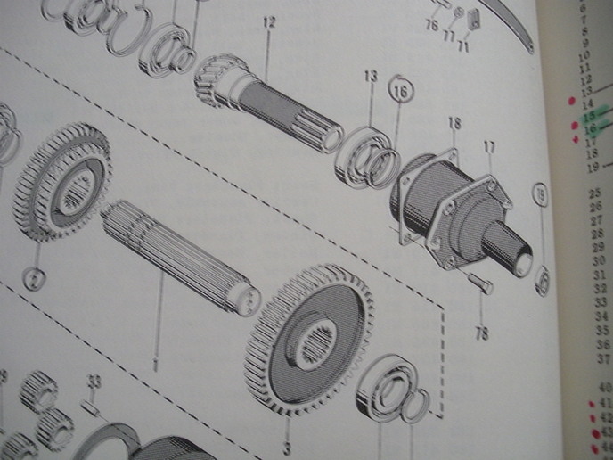

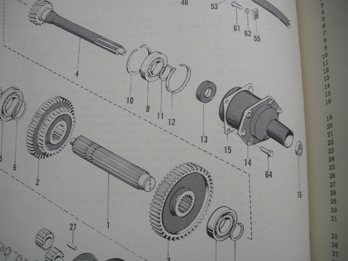

Does anyone know which way the cutout on the transmission input shaft housing should be up or down. It came out facing down but Iím not sure if thatís correct because shaft was leaking

Goes down so the lower gear can run against output shaft. The gear that you drop down to remove assembly from transmission. Be sure and put washer that has lip(lower gear) to inside so snap ring will go on.

From that first illustration that John Deere D posted, it looks like that cutout is there to provide clearance for that gear in the very front. So, yes it has to be down.

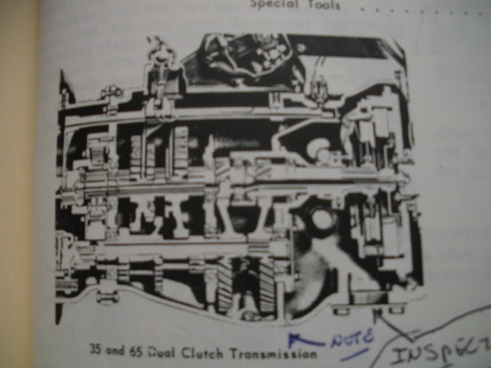

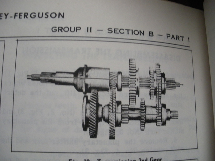

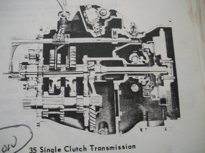

MF INFO:
[Log in to Reply]  [No Email]
John Deere D
09-07-2020 08:40:17
Report to Moderator
 Re: MF35 transmission input shaft in reply to Jwolf1, 09-07-2020 06:02:27
Quote:
Does anyone know which way the cutout on the transmission input shaft housing should be up or down. It came out facing down but Iím not sure if thatís correct because shaft was leaking...
See pics from MF Service Manual .......
Cutout is down......
Hopeful a MF experienced Technician can verify...
Bob...
