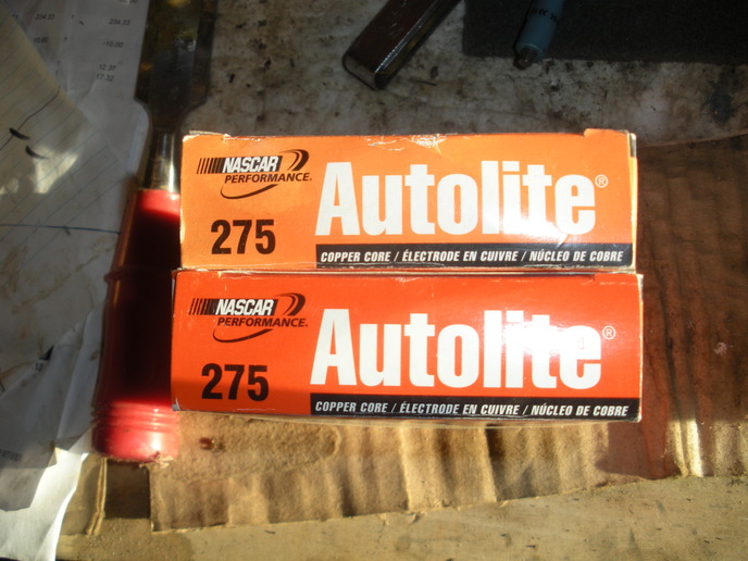

Spark plug Gap.. .032 > .030
Points gap .014 > .016
Engine coolant Thermostat 180 Deg F
My TEA-20 has to work hard... PTO work and it runs well.. as well as large Cultivator usually pulled by a MF 35 X and it runs excellent...
All original 6 Volt system...S # 182991
Pics of plugs.....possibly 200 hrs operating time..
The Champion plugs L86C fouled at less than 200 hrs operating time..
