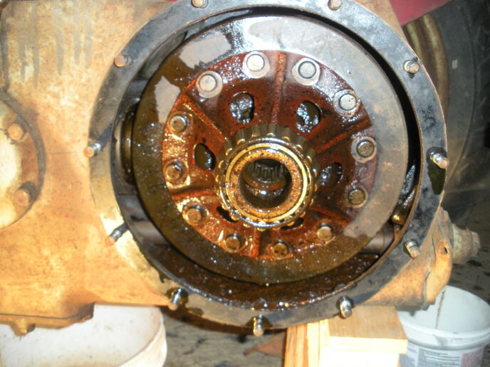

I am looking for info on removing the RHS axle trumpet to fix/tighten the lower link shaft pins.
Good day......
Safety first....
Drain oil...block tractor, Disconnect battery.....etc,
I've replaced the lower lift pins on my Ferguson TEA-20...(1974?) as well as my Ford 2-N (2017)(same procedure)
Drain all oil from Trans, Hyd, Diff. sump...
PIC's of my 2-N Ford.(never had a camera in 1974)
Remove left hand axel trumpet.....
Remove Crown diff as one unit..do not DROP DIFF assembly!
Pins are different on TEA-20's depending on S # of Tractor...
PIC with Torque values...."2-N FORD"
There are those who remove the PTO shaft.... then inset appropriate tool...then tighten inner NUT....???
