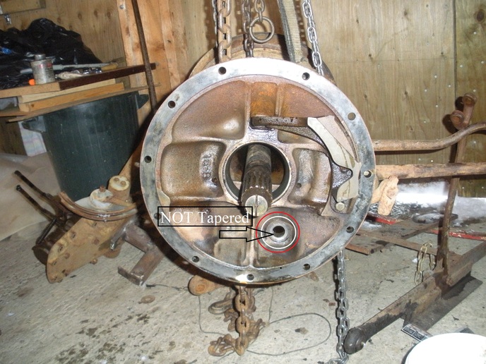

Hello, first of all I would not even bother to try to do anything through the PTO shaft hole........ not even a vet could do it!!!! The axle housing will have to be removed first. If removing the left hand side be careful as the differential may come with it. It can be left on the Rh shaft. Check whether you have a tapered or parallel pin. If a tapered pin ensure that the nut will tighten it. You may have to add a washer under the nut. Check the degree of wear on the pin and in the housing. If it is only minimal and will tighten you can use a metal paste such as JB Weld liberally applied around the pin and casing hole. Allow plenty of time for it to harden.
If itís a parallel pin and too loose for JB you should be able to team or file the hole to a larger diameter and have a slightly larger pin machined

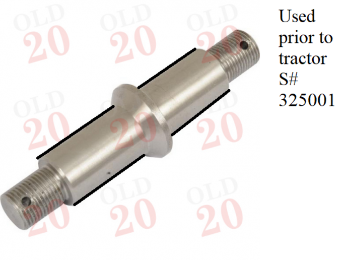

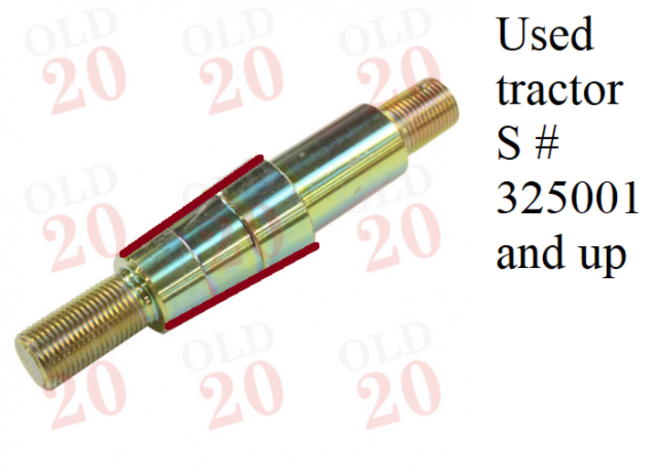

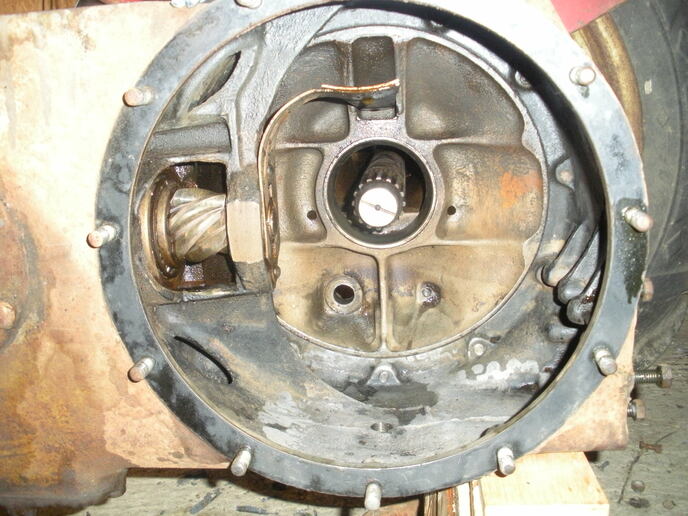

I've replaced the lower lift pins on my Ferguson TEA-20...(1974?) as well as my Ford 2-N (2017)(same procedure)
Drain all oil from Trans, Hyd, Diff. sump...
PIC's of my 2-N Ford.(never had a camera in 1974)
Remove left hand axel trumpet.....
Remove Crown diff as one unit..do not DROP DIFF assembly!
Pins are different on TEA-20's depending on S # of Tractor...
PIC with Torque values...."2-N FORD"
There are those who remove the PTO shaft.... then inset appropriate tool...then tighten inner NUT....???
