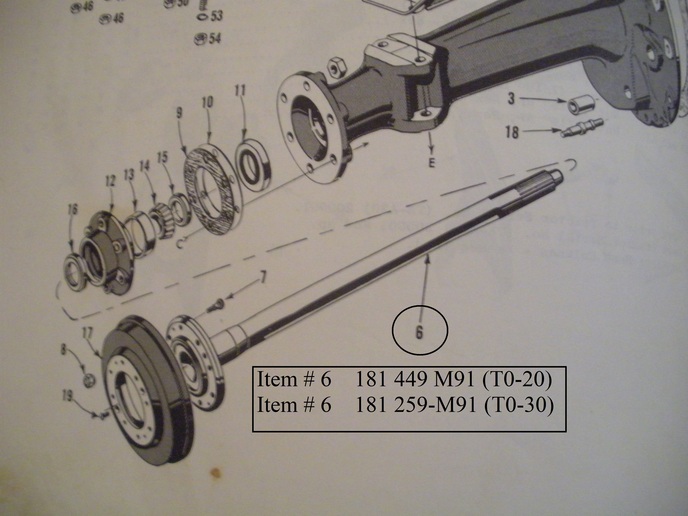

Here is a link to an axle related question from about 16 years ago.
Maybe it will help a bit.
https://www.yesterdaystractors.com/cgi-bin/viewit.cgi?bd=ferg&th=27334
My parts book isn't quite as clear as I wish, but it seems to align with the info in the link I just posted.
TO30 and TO20 axles appear to be different from each other and different from the 9N. Although they list only the "Assembly" and not just the shaft and don't give any further details about specs.
Here's a screen shot of some of the parts book if it helps at all.

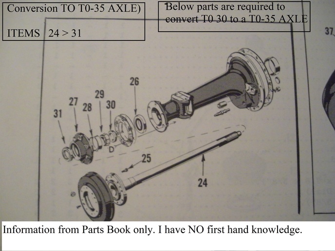

John Deere D
06-30-2020 22:45:16
Report to Moderator
 Re: TO30 Axel Shaft and Battery Support in reply to JeffInCO, 06-30-2020 14:02:32
I have NO experience to verify your concerns....
Pics are from a FERGUSON PARTS BOOK.....
Owner ...Ferguson TEA-20
Bob..

The original Part # is TO4234B. B is important as it is for TO30 and not any Ford or earlier Ferguson such as TO20 Te20 Tea20 etc. HF parts number subs to MF part # 189 648 M91
To 30 had bigger stronger inner axle where it fits into the side gear.
