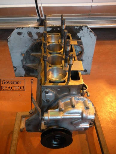

Good Day. My Tea 20 engine jams at slow rotation while turning with the hand crank. If I rotate it quickly it does not jam. Once it is jammed I have to reverse direction (flywheel backwards) to unjam it. I have removed the engine, starter, distributer and front case. Governor weights are in place. When it rotates it moves fine but when it jams it is solid. Any suggestions before I tear this engine apart? Steve

Pulled the head today. Found one bent pushrod. Upon investigation found the tappets (pushrod buckets) in no 2 cylinder seized or moving very little. This appears to be the problem and what was jamming the engine. I think if I had watched the operation of the valve train more closely I would of noticed this irregularity. I have not been able to remove the tappets yet but will post what I find.

So a sticking valve that the piston was closing for you. I understand.
Perhaps a lack of oil changes in the past.

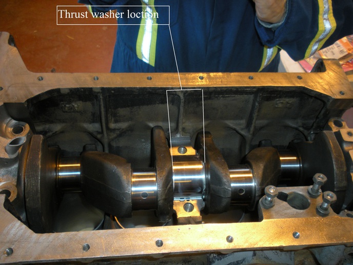

Steve@Advance
11-08-2019 15:41:44
Report to Moderator
 Re: Tea 20 engine jamming in reply to stsew, 11-07-2019 06:55:47
Look at the crank thrust bearing.
Is the flywheel still on? Broken starter drive pieces caught behind the flywheel?

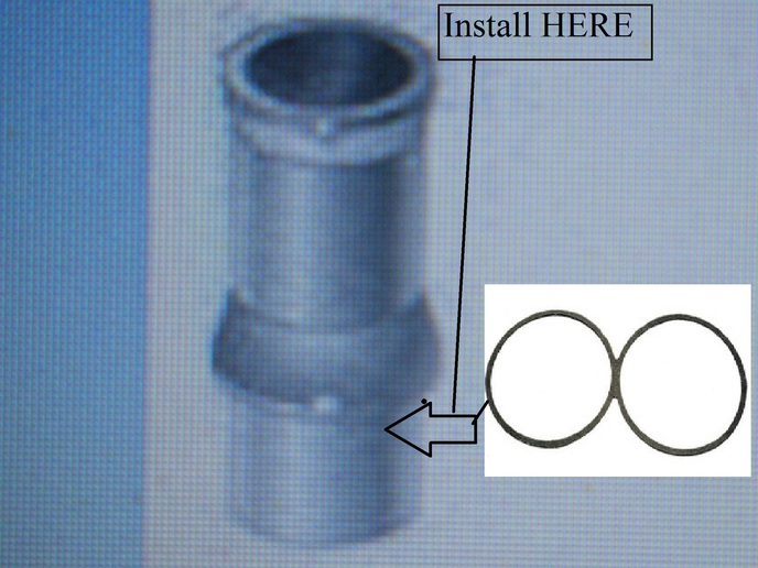

John Deere D
11-08-2019 08:48:27
Report to Moderator
 Re: Tea 20 engine jamming in reply to stsew, 11-08-2019 07:08:23
99.99% of the time...if the liners are NOT secured...they shall move vertically when Crank is rotated...then bottom sealing rings MUST be replaced...coolant always leaks into oil pan...
Bob...Owner TEA-20..

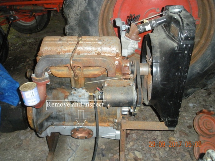

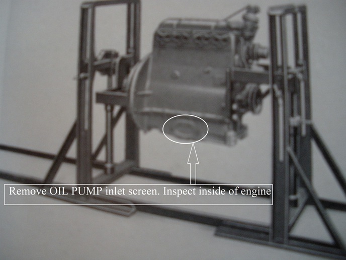

John Deere D
11-07-2019 08:41:59
Report to Moderator
Remove inspection plate / Inlet oil pump screen...view the interior of the oil pan / engine...

Valve sticks open and the piston hits it and closes it for you. . .
