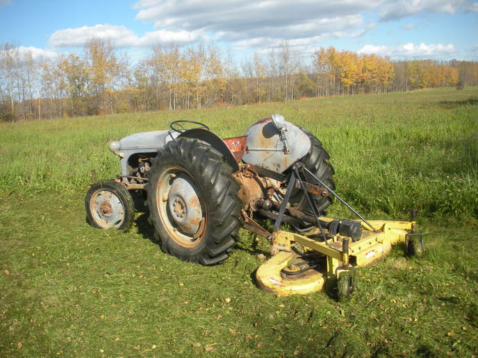

Two things that help if the top link on the mower is ridged make up a chain top link. If the mower is not as wide as the tractor I offset the hitch so that it sticks past the left side this lets you mow close to stuff and lets you mow with only one wheel running over what you are mowing the other one is running where you have already mowed.

(quoted from post at 17:33:11 09/21/19) I offset the hitch so that it sticks past the left side this lets you mow close to stuff .
Any chance of a photo Sunbeam ?
I use a four foot wide one now , I find it a lot more nimble and easy to maneuver around trees but there is always a grass margin left .
Without an offset built into the implement I can't see how it can be done without cutting and welding .
