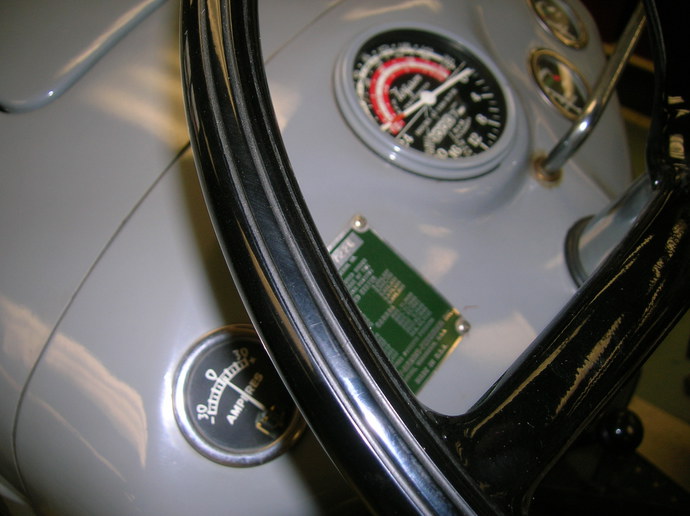

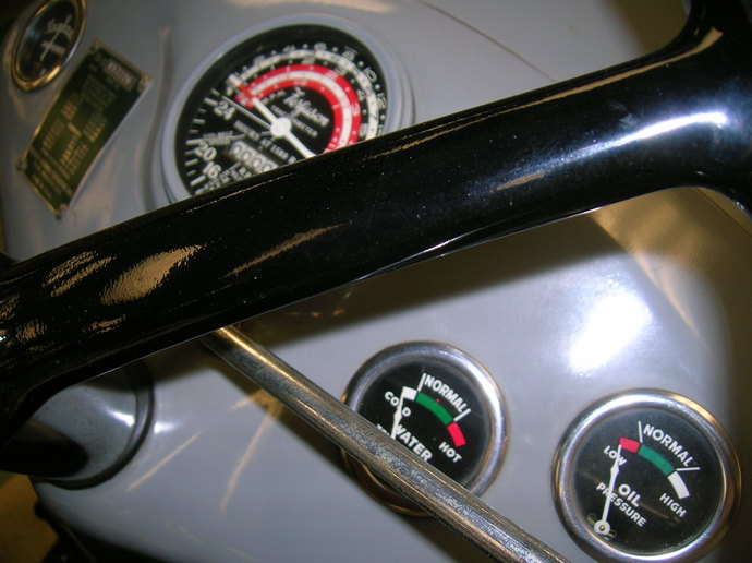

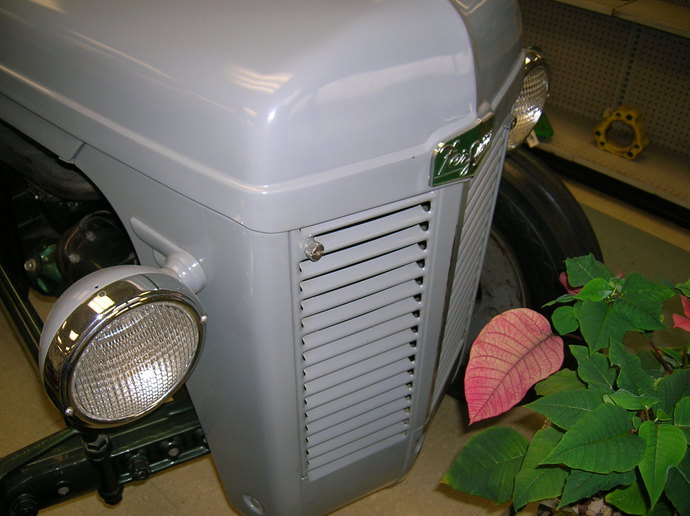

 Re: New Owner Asking For Help in reply to qesiii, 07-12-2019 07:56:11
these are photos of a 55 TO-35 at Wengers in Myerstown pa.
notice the shape of the dash as it is different than later ones.
[Log in to Reply]  [No Email]

steve19438
07-12-2019 12:00:45
Report to Moderator
the two push buttons on the good is correct for 1955
the MF badge on the front of the hood does not belong
the carb looks like a zenith. I thought MS carbs were on 55's.
I not see a cover plate where the pwr steering pump would mount so that indicates a fairly early 55.
the holes at the back of the hood are correct

Richard L
07-15-2019 16:43:08
Report to Moderator
 Re: New Owner Asking For Help in reply to qesiii, 07-12-2019 10:56:34
qesiii, I noticed you told Bruce you would paint it Red & Gray. If you look at the pictures steve14938 posted for you that is the way your tractor left the factory. This may help you: http://fergusontractors.org/nfs/wp-content/uploads/2018/07/Ferguson-Color-Chart-7-1-18.pdf
