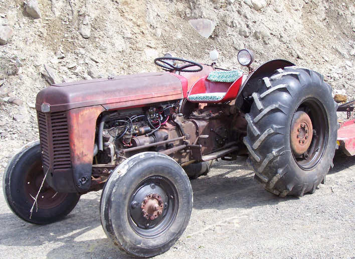

Here's the story. Crankshaft ground, new main bearings, new rod bearings. Sleeve and pistons were relatively new, I did put new rings on them. Head was refurbished with new valves. Brand new rocker assembly. Valves were set, engine was ran then valves set again to .013. Oil pump rebuild. New governor. New water pump.
I have a pecking or ticking noise that I can't track down. I have pulled the oil pan and timing cover to check everything and nothing shows up. I am not exactly an expert as this is only the second Continental engine rebuild I have dove into.
The oil pump gear back lash is more than it should be, but I have removed all the shims and it is as tight as I can get it.
I briefly ran the motor with the fan belt off to see if the noise was coming from the water pump or alternator and its not. I pulled the power steering pump and ran the motor without it and that's not the culprit either.
Oil pressure is 35-38. It runs fine and has good power. I have mowed with it a few times and it has more power than my TO30 (which also has a new engine rebuild)
I would not decribe it as a knock, like a rod knock. But there is a noise that should not be there.
Anyone else dealt with an issue like this?

I had a gentleman who knows old engines listen to it and he believes the noise is coming from the camshaft. Since there are no bushings on this camshaft, it's just going to be run like it is. Maybe someday I will tear it down again and check all the camshaft specs and see what could be done. As for now, I will just work it and enjoy every second. Sure turns easy with that power steering as compared to my TO30.
Thanks for the input, I am moving on! Now to address an oil leak around the lift shaft. Always something.....

Mowed a bit today with it and pulled each plug wire to see if sound changed. I don't believe there was a difference in the noise when any wire was removed. Valve rocker assembly was just purchase new and has plugs. I am going to set the valves again sometime in the next month or so.
Right now I am just gonna to use it and see what happens, oil pressure is good. It runs well, as it should with all that has been done. I guess I can add a radio on the fender and just crank it up to drown out the pecking noise.

I originally thought it was from the valve rockers as the assembly I had was worn way beyond book specs. Bought a brand new rocker assembly and reset valves to .013 warm and the sound is still there. (Which is what I get for changing parts without knowing the exact cause, but the old rocker assembly was definitely worn out)
When I get time I am going to try setting valves tighter and then try your suggestion of pulling each plug wire to see if sound changes, thanks.

 Re: z134 mystery pecking noise in reply to 54FergieTO30, 06-12-2019 19:53:51
Try pulling one plug wire at a time, see if the sound changes.
If it does, could be a wrist pin, loose piston skirt clearance, rod bearing, main...
Usually a rod will have a double rap, and loss of oil pressure.
A main more so under load, deep bottom knock/rattle.
But a wrist pin or skirt slap can run for years without a problem.
If the sound does not change, could be a valve train noise. Check the lash with a feeler gauge while running. Look for a bent pushrod, dry rocker bushing. Be sure the plugs are in the ends of the rocker shaft.
Did you check the teeth of the cam and crank gears carefully? Those are known for the governor ball cage breaking. A piece of a broken cage could be jammed into one of the gears.

wrist pin bushing - often overlooked during engine rebuilds - a much 'lighter/higher' sound than a low end rod knock - usually I wouldn't describe it as 'pecking/ticking' which would mostly be associated with the valve train, it's also hard to isolate as it's about as internal as it can get in the engine - something to consider - also as you look for the noise I'd suggest you carefully inspect your valve springs, even if new, one could have broken

I built one and had valves make noise. Had to re-adjust and set just a little tight. Did you set valves cold or hot? Try setting with engine running and see if you can take noise out. I use a quart bottle with hose for gas.

Could be coming from oil pump gear and crankshaft gear. When I pulled oil pan the new oil pump gear already had some wear showing.

INFO from MF SERVICE MANUAL:
TIMING GEARS:
New Oil Pump Gear to Crankshaft Gear Backlash....0.008-0.010 inch

Stethoscope......or....long handled Screwdriver.....Ear Muffs (Hearing protection)... place handle of screwdriver against Ear Muff and listen at various locations on you Engine.....yes with Engine running...
