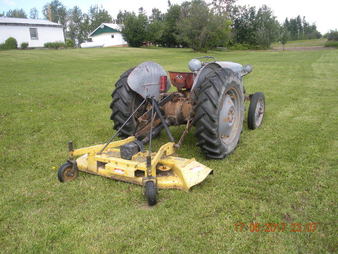

The tractor has a continental 4 cylinder overhead engine in good shape. 4 speed transmission and a step up and step down secondary transmission. It runs a 4 foot John Deere and a 4 foot woods bushhog mowers easily. Is a 5 foot bushhog mower too much for my Ferguson?
Should be ok. I ran a 5 foot on my TO30 no problem. Make sure you get an overrun clutch. They come with 1-1/8 and 1-3/8 inputs. It will allow you to stop easier.

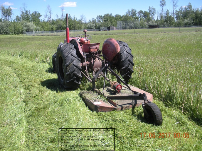

Our 48"in HEAVY GREEN VEG....TEA-20 can handle only 30" MAX as it has a 4 speed Trans. and the gearing is fast:
The groomer on the other hand preforms excellent with the TEA-20...
Bob...

Good information and pictures. Including a picture of our 1948 TE 20 with a 4 foot woods bushhog. The Sherman transmission which our tractor has with the step down feature is a benefit in heavy grass.
Tom H
I have a 1 3/8 pto shaft and an overrun clutch. I think your TO 30 has more hp than my TE 20 Thanks for the information
Duner WI
I think the TE 20 is smiliar to the TO 20 but used an engine made in England? A five foot mower would probably work with my TE 20 4 foot woods bushhog works very well with my TE 20
