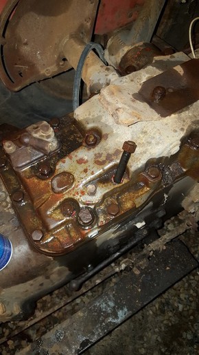

I have went through pump with orings and relief valve and new lift piston and rings...a lot of water and sludge..lift worked ok before i did it but it sure needed the cleaning..question,i installed a 5000 psi gauge to see if it checked out...with nothing hooked to 3 point hookup no pressure showed on gauge till it was at very top.had 3000 and relief bought it down to 2700..didn't leave it there long...should you adjust the top stop down so this wouldn't happen if you pulled the control all the way up..have never checked one with gauge but looks like it would be bad to have full pressue all the time in travel setting...i adjusted top cover settings and everything works to my liking but this don't seem right but i don't know

That pressure is more than I'd like to see, and the top stop needs reset down a bit. The system should NEVER blow the relief valve with the arms fully raised! Lift the arms by hand all the way up, and scribe a line across the arm and cover. Now with the lift stop set it to stop the arms with the scribe line 1/8 inch apart to protect the system.
Thanks for both replys...the manual says pressure 2550 to 2750.the relief i bought is a 2700..tractor is a 1957 model and relief is identical to what i had.........lift didn't slam..comes up slow with cold 90w gl1...thanks for telling me how to set the top stop...from the both of you i gather i should not see any pressure on gauge with nothing on lift at top....i take it the only way to show pressure is to chain the arms which i by accident have already tested max pressure...it would be interesting how many tractors top travel setting is like this one...how would you know without a gauge... manual i have doesn't go into this at all..so glad i ask..thanks again
I have come across several TO35 and MF50 tractors for sale that when running and the lift arms are fully raised you can hear the engine pull down slightly as the arms go up to far and the relief valve starts blowing. I know to listen for it so I notice it but I think a lot of people have no idea it is doing that all the time. If something ever clogs their relief valve there will be a bang!
